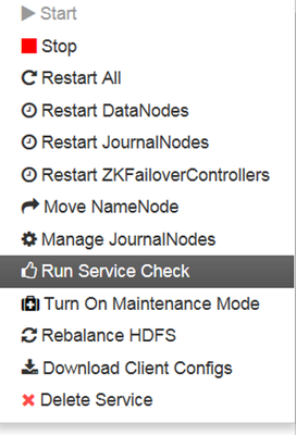

as all know we can do service check on each of the services in ambari cluster
what we need is a tool or script or API that will perform service check on all ambari services and will print the resulsts as ok or fail
