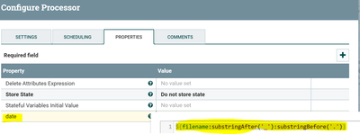

First you need to extract the date from filename and keep it as attribute to the flowfile by using
Update Attribute processor:-
add new property
date
${filename:substringAfter('_'):substringBefore('.')}
Configs:-

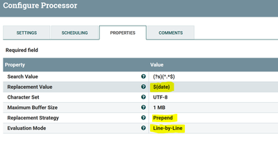

Then use Replace text processor to prepend the existing flowfile csv data with extracted date attribute
Change the
Replacement Value
${date}
**keep space after ${date} in above.
Maximum Buffer Size
1 MB //if your flowfile content is more than 1 MB then you need to change this value.
Replacement Strategy
Prepend
Evaluation Mode
Line-by-Line
Configs:-
So in this processor we are just prepending the data with date attribute that is extracted in Update attribute processor and we are going to prepend date value Line-by-Line evoluation mode.

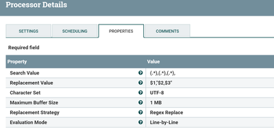

Then use another replace text processor to replace last , with double quotes "
Search Value
Replacement Value
$1,"$2,$3"
Maximum Buffer Size
Regex Replace
Evaluation Mode
Line-by-Line
Configs:-
So in this processor we are extracting all the data between last 2 commas and then replacing first group as is and enclosing group2 and group3 with double quotes and removing , at last.

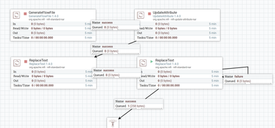

I have attached the xml file you can use the same xml file and change the configs as per your needs.
Flow:-
Reference xml:-
date-155661.xml

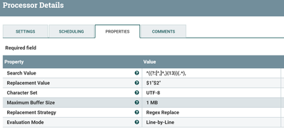

If you know 13 columns before the string then you can use Replace Text processor that matches until 13th comma then match everything after 13th comma until last comma(not including last comma).
Replace text processor Configs:-
Change the below properties as
Search Value
^((?:[^,]*,){13})(.*), //capture group 1 until 13th comma and capture group 2 after 13th comma until last comma
Replacement Value
$1"$2" //keep 1 group as is and add double quotes for 2 group
Maximum Buffer Size
Regex Replace
Evaluation Mode
Line-by-Line
Configs:-
By using above search value property we are just replacing as is until 13th comma and matching whole content after 13th comma until last comma and enclosing whole content in double quotes(").
