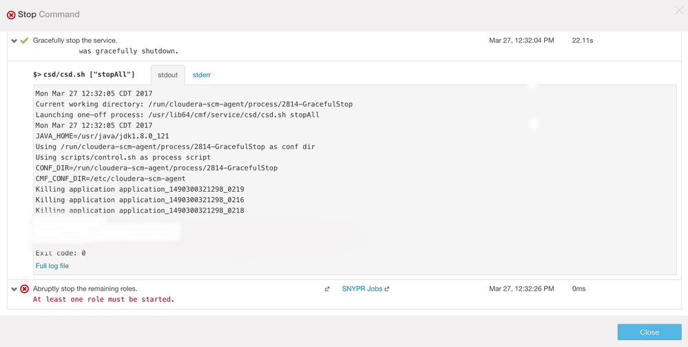

Hi Darren,
Thank you very much for a quick response.
Please find attached the screenshot displaying the error. The error says
"atleast one role must be started".
I had to write a custom stopRunner for the service as the roles were used
to start a spark job which escapes the Cloudera Manager's stop action.
Please let me know how I could fix this or if I can skip the "abruptly
stop".
Thank you.
Regards,
Chandni Shankar
Thanks for this report!
This does indeed appear to be a bug (Paolo dug into it internally, credit to him) and we'll get a fix out in a future release.
The abruptly stop step should skip when there's no started roles, rather than error.
Thanks,
Darren
