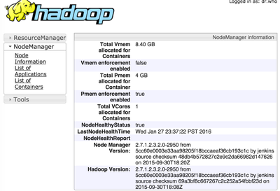

This address is available on all nodes that have a Yarn Nodemanager installed (usually they are running on the same nodes as the Datanodes). You might have to use the external address that Amazon EC2 provides.
http://<nodemanager-address>:8042/node shows the following information:
1607-screen-shot-2016-01-28-at-83907-am.png1607-screen-shot-2016-01-28-at-83907-am.png
