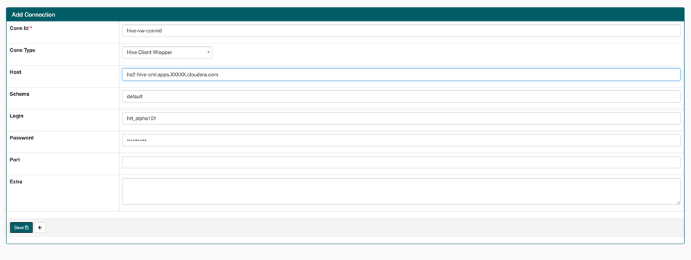

Add the Hive|Impala connection details as shown in the following screenshot (available under Admin > Connections).

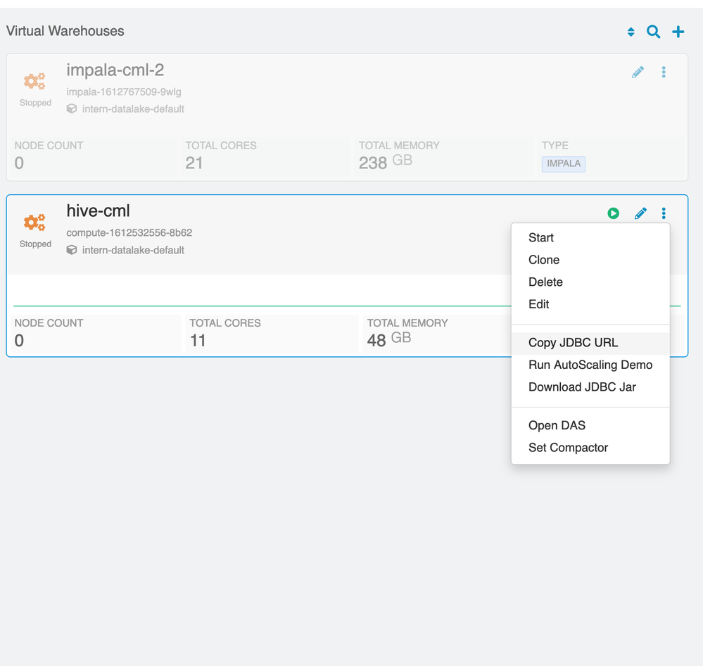

The hostname can be obtained from the Copy JDBC Url of Hive/Impala virtual warehouse as follows:

Note: The username/password will be CDP workload username and password.

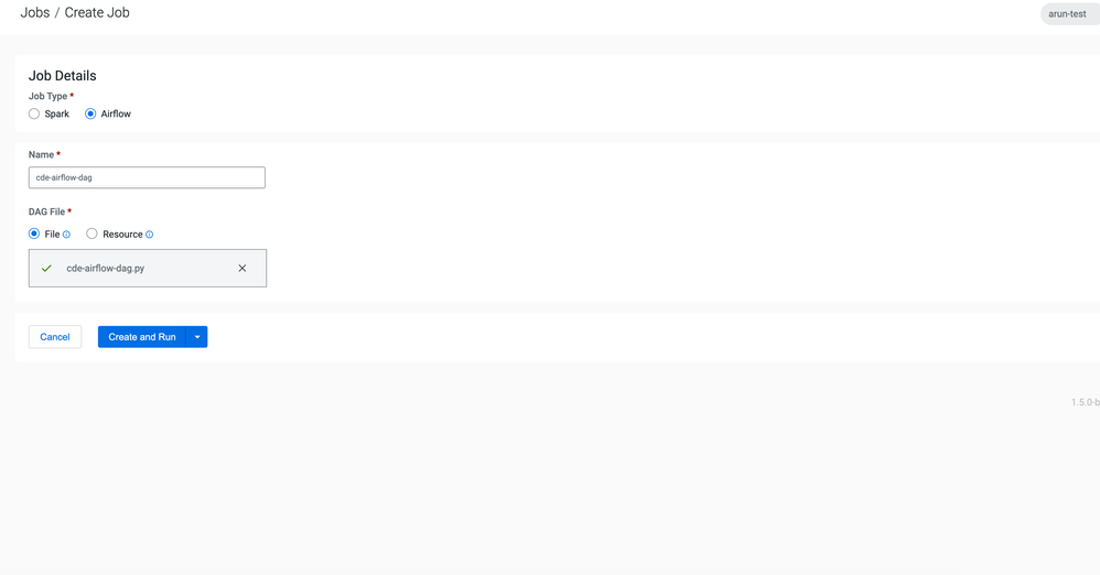

Before submitting the job, upload the Provider.csv, to the CDP S3 bucket. Then, submit the Airflow dag
from CDE job create UI as follows:
Note: Replace the test_data_bucket in the dag code with the bucket name applicable.

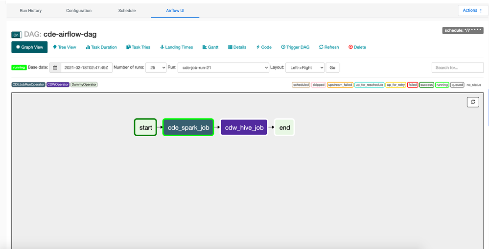

There you go, we have scheduled an Airflow job to read from the S3 bucket and load to CDW Hive virtual warehouse.

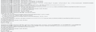

hello @SanthoshGowda   Connecting impala VM  in the same way will report an error, hive VM is ok.
 any idea ?
Expert Contributor
Hi @archer2012 , that error output doesn't give us a lot of information about what went wrong, but it looks like the connection wasn't successful. I recommend using Beeline in verbose mode from a command line on a suitable node to troubleshoot the connection independently. Once you have the connection to Impala working separately, then you can come back to Airflow and use the working connection settings.
