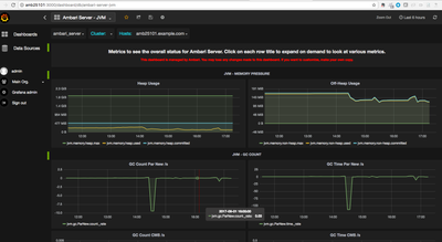

Ambari JVM/Database Monitoring using Grafana
Check-6). From Ambari 2.5 onward, We can also check the ambari performance statistics related to ambari jvm and database. For more information on this please refer to: https://docs.hortonworks.com/HDPDocuments/Ambari-2.5.1.0/bk_ambari-operations/content/grafana_ambari...
http://$GRAFANA_HOST:3000/dashboard/db/ambari-server-jvm
http://$GRAFANA_HOST:3000/dashboard/db/ambari-server-database
