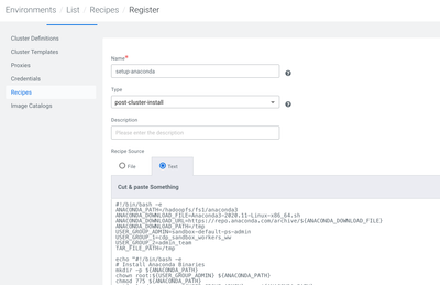

  6. Upload the script into the recipe section in the CDP Control plane.setup-recipe-conda.png

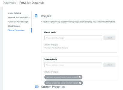

  7. You can now attach the recipe during cluster provisioning. Here is an example where the 'setup-anaconda' recipe is attached to the gateway host.

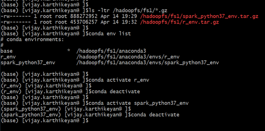

  8. Once the cluster is built, you should see the tar.gz files in the TAR_FILE_PATH path and should also have access to the conda commands on the node(s) where the recipe(s) were executed. Please note that the user has to run the command conda init bash before running these commands. Here is a view of the commands from the gateway node.
