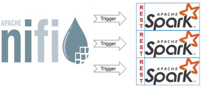

 As the payload arrives in s3, CDF-X's (Cloudera Data Flow Experience) s3 processor listens for any files. CDF-X will pull the files, decompress, and write all the files back to s3. For example:
s3://My-S3-Bucket/decompressed/file1.json,  3://My-S3-Bucket/decompressed/file2.json, ...
2021-08-30_15-07-11.jpgIn parallel CDF-X generates CDE (Cloudera Data Engineering, Spark) a job spec, a JSON payload. The job spec includes file locations.  Each job would be provided with roughly ~100 file names+location. Since CDF-X knows about the file size, it can also hint to CDE how much compute would be required to process these files. This step is not necessary as we are already defragged the unit of work to something manageable, and therefore CDE autoscaling should kick in and perform well. Once the job spec is created, CDF-X calls CDE over the rest sending over the job spec. CDE accepts the job spec and arguments (file locations) and runs the micro workloads. Each workload has its own heterogeneous compute profile and auto-scales independently.
