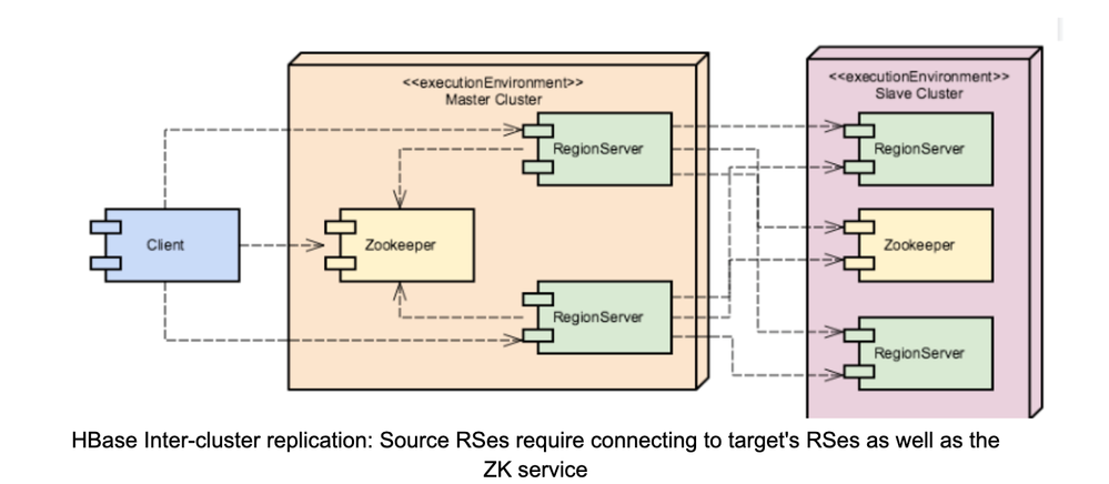

One missing piece left unsolved by the original Cloudera Replication Plugin design was ZooKeeper connections to the target cluster. Back when the initial plugin version was under development, information from the target cluster, like cluster ID and the list of its RegionServer addresses required by the replication source was only exposed in the target's ZooKeeper service. Due to the lack of support for similar pluggable authentication types in the ZooKeeper client library, we had to relax our security constraints when reading such info from the target ZooKeeper service. ZooKeeper release in use at the time didn't enforce authentication, meaning any unauthenticated client could still access information on its znodes. That is mitigated by the use of ACLs for the HBase znodes and since HBase only stores cluster related metadata (not user data) such as server addresses and region locations, that was a minor compromise.

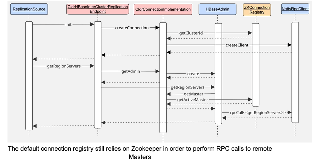

Within the ever evolving open source ecosystem, both ZooKeeper and HBase have seen new functionalities being implemented and included in latest releases that allow for eliminating that last pitfall in ZooKeeper data protection. First, ZooKeeper incorporated the “authentication enforcement” feature (ZOOKEEPER-1634), which is configurable and once activated, it blocks non-authenticated clients from accessing znodes. The alternative was to modify the plugin, to access the list of RSes via the target Master RPC API, which already exposes this. But to establish this RPC connection, the client (the replication source) still needs to resolve the target cluster active master address and cluster ID. This is performed internally in the client RPC connection, and by default, it also relies on ZooKeeper data, which now isn’t available for the replication source because it lacks Kerberos credentials for the target cluster.

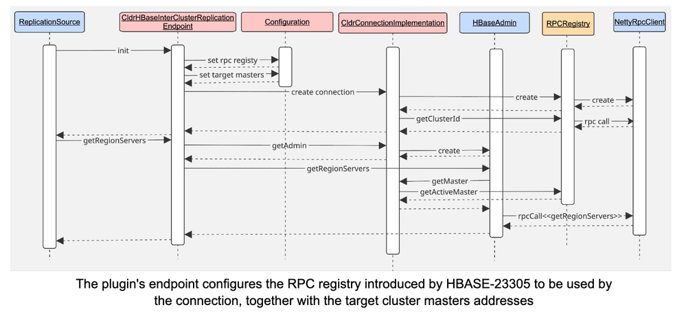

With no means to access data from the target cluster’s ZooKeeper, the Cloudera Replication Plugin Endpoint needs to switch from the default ZooKeeper based connection registry to the new Master RPC only introduced in HBASE-23305 prior to creating a connection instance. This master RPC registry relies on local cluster HBase master configurations to resolve the master addresses, so the plugin needs to define an extra configuration property for specifying the target cluster's master addresses. It then uses this new property to override the configuration it passes for the connection to the target cluster.
Now every meta information from remote peers required by the source replication endpoint is fetched via RPC, using the same custom SASL mechanism originally implemented by the Cloudera Replication Plugin. Target clusters can enable enforced ZooKeeper Authentication to strengthen security, without impacting replication setups.
