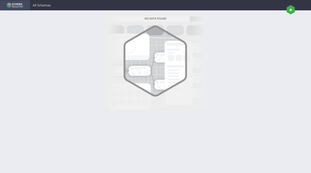

Deploy Schema Registry (CSM 1.6)
To manage our data serialization and ensure compatibility across the stack, we deploy the Cloudera Schema Registry. This allows us to define a schema for data that NiFI, Kafka, Flink, and SSB can easily decipher.
Create the sr-values.yaml file as follows:
sr-values.yaml
tls:
  enabled: false
authentication:
  oauth:
    enabled: false
authorization:
  simple:
    enabled: false
database:
  type: in-memory
service:
  type: NodePort
Execute the following helm command to install Schema Registry:
# Install Schema Registry from the Cloudera OCI Registry
helm install schema-registry \
--namespace cld-streaming \
--version 1.6.0-b99 \
--values sr-values.yaml \
--set "image.imagePullSecrets[0].name=cloudera-creds" \
oci://container.repository.cloudera.com/cloudera-helm/csm-operator/schema-registry
Notice the following output:

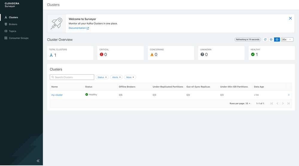

Deploy Kafka Surveyor (CSM 1.6)
A new standout in the CSM Operator 1.6 is Kafka Surveyor. This provides advanced observability into your Kafka environment. It is a game-changer for monitoring broker health and topic metrics in a Kubernetes-native way.
Before we can create a surveyor yaml we need to find our kafka bootstrapServers:
kubectl get kafka my-cluster -n cld-streaming -o jsonpath='{.status.listeners[?(@.name=="plain")].bootstrapServers}'
Grab the following from the output:
my-cluster-kafka-bootstrap.cld-streaming.svc:9092
and use it to create the surveyor-eval.yaml as follows:

Execute the following helm command to install Cloudera Surveyor:
helm install cloudera-surveyor \
  --values kafka-surveyor.yaml \
  --set image.imagePullSecrets=cloudera-creds \
  --set-file clouderaLicense.fileContent=./license.txt
Pulled: container.repository.cloudera.com/cloudera-helm/csm-operator/surveyor:1.6.0-b99
Digest: sha256:7e12c2b2ab8aca0351296f5c986d64d55a92b66e7ac6b599ccbd5b3fa9c13167
LAST DEPLOYED: Mon Mar  9 13:18:14 2026
NAMESPACE: cld-streaming
STATUS: deployed
REVISION: 1
DESCRIPTION: Install complete
TEST SUITE: None
NOTES:
Thank you for installing surveyor.
Your release is named cloudera-surveyor.

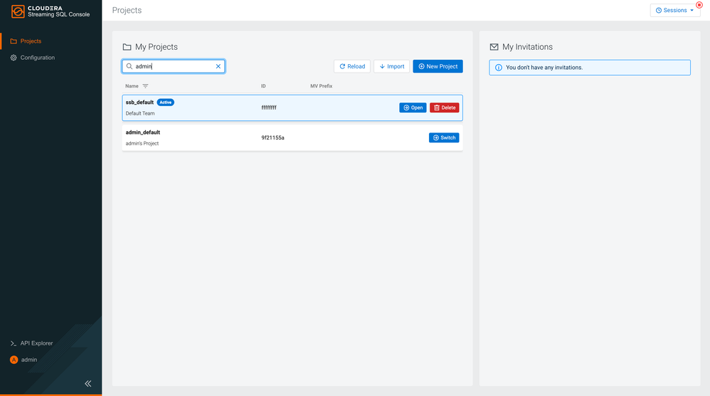

Deploy SQL Stream Builder (CSA 1.5)
To get started with SQL Stream Builder first we need to install the Cloudera Streaming Analytics Operator:
kubectl create -f https://github.com/jetstack/cert-manager/releases/download/v1.8.2/cert-manager.yaml
kubectl wait -n cert-manager --for=condition=Available deployment --all
helm install csa-operator --namespace cld-streaming \
    --version 1.5.0-b275 \
    --set 'flink-kubernetes-operator.imagePullSecrets[0].name=cloudera-creds' \
    --set 'ssb.sse.image.imagePullSecrets[0].name=cloudera-creds' \
    --set 'ssb.sqlRunner.image.imagePullSecrets[0].name=cloudera-creds' \
    --set 'ssb.mve.image.imagePullSecrets[0].name=cloudera-creds' \
    --set-file flink-kubernetes-operator.clouderaLicense.fileContent=./license.txt \
    oci://container.repository.cloudera.com/cloudera-helm/csa-operator/csa-operator
Pulled: container.repository.cloudera.com/cloudera-helm/csa-operator/csa-operator:1.5.0-b275
Digest: sha256:2ee057584ec167a9d70cabbe9a4f0aa8cd93ddf74e73da3c2617a829a87e593c
LAST DEPLOYED: Mon Mar  9 14:43:32 2026
STATUS: deployed
REVISION: 1
TEST SUITE: None

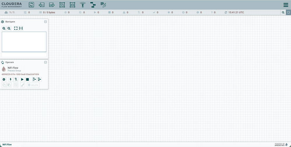

Deploy NiFi (CFM 3.0)
Next, we will deploy NiFi using the standard evaluation spec. This gives us a fully functional NiFi instance without the overhead of complex external persistence.
First, install the CFM 3.0 Nifi Operator:
helm install cfm-operator oci://container.repository.cloudera.com/cloudera-helm/cfm-operator/cfm-operator \
  --version 3.0.0-b126 \
  --set installCRDs=true \
  --set image.repository=container.repository.cloudera.com/cloudera/cfm-operator \
  --set image.tag=3.0.0-b126 \
  --set "imagePullSecrets={cloudera-creds}" \
  --set "authProxy.image.repository=container.repository.cloudera.com/cloudera_thirdparty/hardened/kube-rbac-proxy" \
  --set "authProxy.image.tag=0.19.0-r3-202503182126" \
  --set licenseSecret=cfm-operator-license \
Create the nifi-eval.yaml as follows:
nifi-eval.yaml
apiVersion: cfm.cloudera.com/v1alpha1
kind: Nifi
metadata:
  namespace: cld-streaming
spec:
  replicas: 1
  nifiVersion: "1.28.1"
  image:
    repository: container.repository.cloudera.com/cloudera/cfm-nifi-k8s
    tag: 3.0.0-b126-nifi_1.28.1.2.3.17.0-9
    pullSecret: cloudera-creds
  tiniImage:
    repository: container.repository.cloudera.com/cloudera/cfm-tini
    tag: 3.0.0-b126
  hostName: mynifi.localhost
  uiConnection:
    type: Ingress
  configOverride:
    nifiProperties:
      upsert:
        nifi.cluster.leader.election.implementation: "KubernetesLeaderElectionManager"
    authorizers: |
      <authorizers>
        <authorizer>
          <identifier>single-user-authorizer</identifier>
          <class>org.apache.nifi.authorization.single.user.SingleUserAuthorizer</class>
        </authorizer>
      </authorizers>
    loginIdentityProviders: |
      <loginIdentityProviders>
        <provider>
          <identifier>single-user-provider</identifier>
          <class>org.apache.nifi.authentication.single.user.SingleUserLoginIdentityProvider</class>
          <property name="Username">admin</property>
          <property name="Password">$2b$10$GRa8g9Z5rBENXPFNHFBosev9XmY6CSk0SdcBi5sQMRX92KD73asGG</property>
        </provider>
      </loginIdentityProviders>
  stateManagement:
    clusterProvider:
      class: org.apache.nifi.kubernetes.state.provider.KubernetesConfigMapStateProvider
Execute the following kubectl apply command to create the nifi cluster:
kubectl apply -f nifi-eval.yaml -n cld-streaming

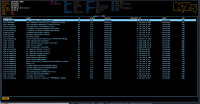

Final Verification
The best way to see the fruits of your labor is via k9s.
# Check the deployment progress
k9s
VidyaSargur_2-1773296224526.pngBe Patient! It will take quite a bit of time for the entire stack to be online and running.
Behold: The full Cloudera Streaming stack running harmoniously in your local minikube cluster.

minikube service cloudera-surveyor-service --namespace cld-streaming
minikube service schema-registry-service --namespace cld-streaming
minikube service ssb-sse --namespace cld-streaming
minikube service mynifi --namespace cld-streaming
