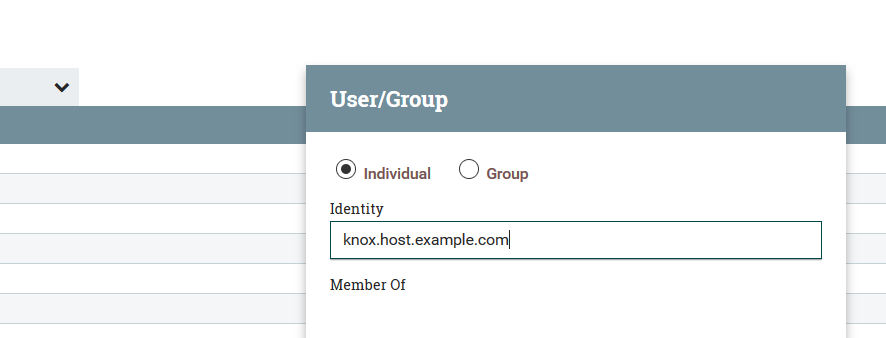

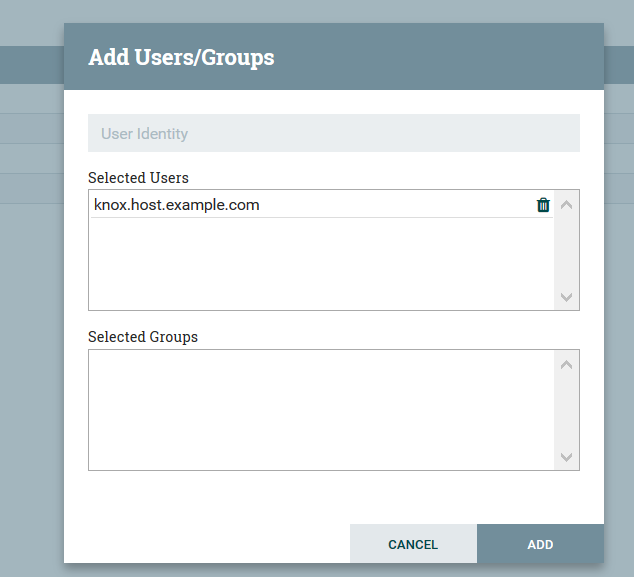

Login to NiFi UI as the admin user and add Knox hostname as a user and add the proxy request privilege to the Knox host user.
Once knox DN is added as user, go to policies, select the policy “proxy user requests” and click on add user button. Select the knox host user you just added and click on ADD.

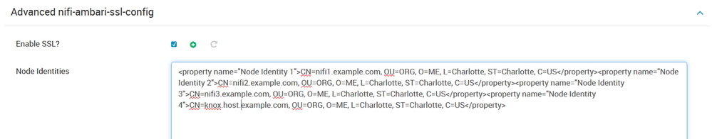

Add the DN obtained from above step, and add it as a node identity in NiFi configuration as shown below. The last entry in the screen shot is the knox DN:
Advanced nifi-ambari-ssl-config:
nifi.security.needClientAuth = true
Add an entry in the “node identities” check box on ambari nifi configuration page, and add the full DN of the knox host from the knox certificate.

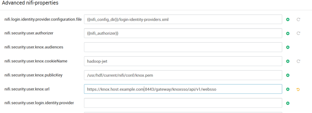

Advanced nifi-properties:
Make the following changes in ambari.
Please note that nifi.security.user.login.identity.provider should be empty when you configure for knox SSO. Usually we see “ldap-provider” in this property. If you see it, make it empty.

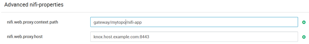

In the following configuration, replace “mytopo” with the name of the “topology” name. the knox host name and port should be entered in “nifi.web.proxy.host”

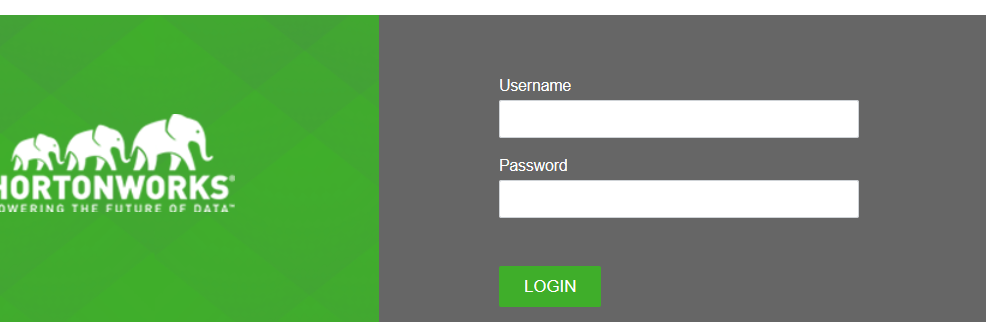

It will take you to the knox SSO page, and then you can enter the user credentials and it will take you to the NiFi UI canvas.
