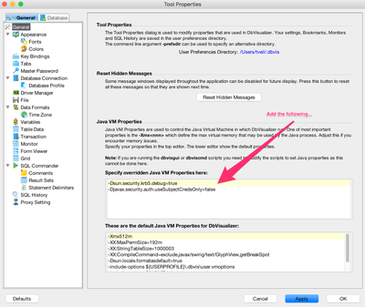

  2. Open DbVisualizer preferences ("DbVisualizer" > "Preferences") and add the following properties. DbVisualizer will need to be restarted after applying these changes.
    -Dsun.security.krb5.debug=true
    -Djavax.security.auth.useSubjectCredsOnly=false

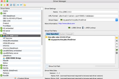

  3. Open the Diver Manager dialog ("Tools" > "Driver Manager...") and hit the "Create a new driver" icon.
  4. Fill in the information as seen below. For the "Driver File Paths" you are pointing to the hive-jdbc-uber-x.jar that you just downloaded.
    jdbc:hive2://<server>:<port10000>/<database>

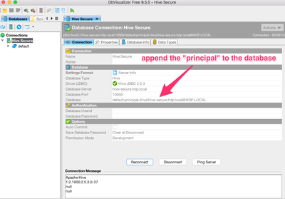

  5. Create a new connection ("Database" > "Create Database Connection") and fill out the details based on your cluster as seen below. Please note that you must append the "principal" to the "database" parameter for kerberized connections.
  6. Hit the "Connect" button to test the connection. You should see something like the following in the "Connection Message" text area if the connection is successful.
    Apache Hive

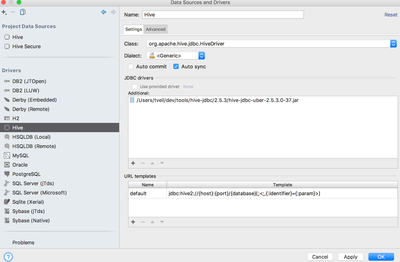

  2. Under "File" > "Data Sources...", create a new Driver. Make sure you load the hive-jdbc-uber-x.jar that you just downloaded.
    jdbc:hive2://{host}:{port}/{database}[;<;,{:identifier}={:param}>]

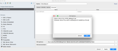

  3. Create a new "Project Data Source" using the new Driver. On the "General" tab, do the following:
    Then add the following flags to "VM Options" on the "Advanced" tab.

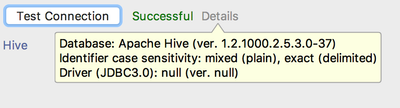

  4. After creating the "Project Data Source", test the connection. You should see the following:
