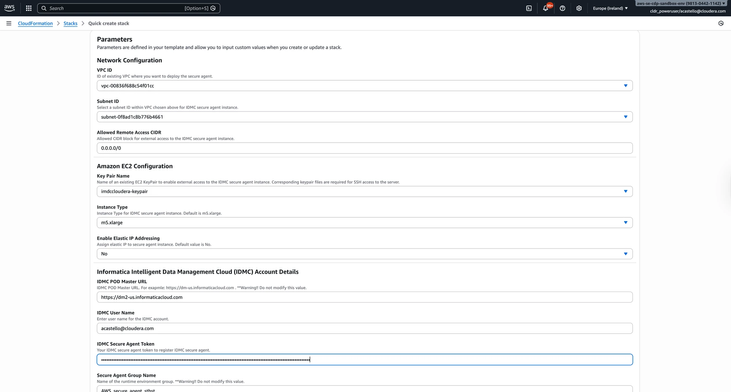

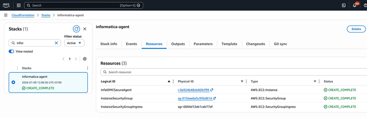

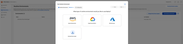

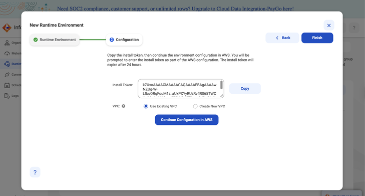

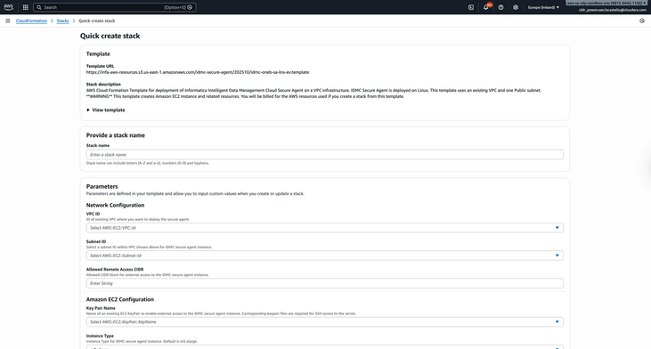

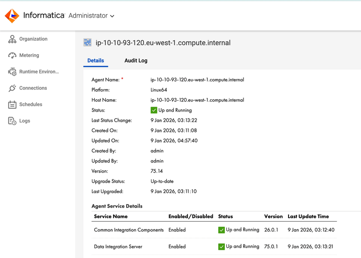

Installation of Informatica Secure Agent
Details to install Informatica Secure Agent on AWS
Below images are examples; You'll need to customise the parameters to your needs

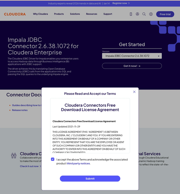

Note: There are no Hive or Impala JDBC jar drivers installed on the Informatica Cloud Secure Agent by default.
  • Upload it to the Informatica Cloud Secure agent, probably via a Jump host, as it doesn’t have a public IP
scp -i "imdccloudera-ssh-key.pem" ClouderaImpalaJDBC42-2.6.38.1072.zip [email protected]:/tmp/ClouderaImpalaJDBC42-2.6.38.1072.zip
scp -i "imdccloudera-ssh-key.pem" ClouderaHiveJDBC42-2.6.29.1037.zip [email protected]:/tmp/ClouderaHiveJDBC42-2.6.29.1037.zip

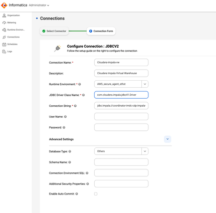

Create an Informatica JDBCv2 connector for Impala

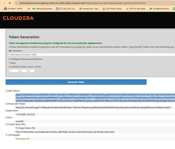

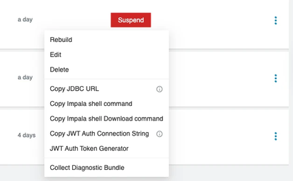

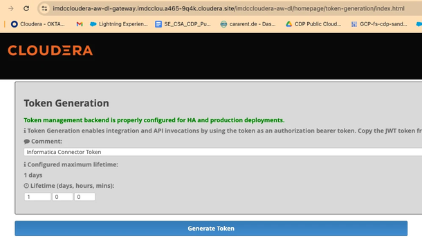

Note: To authenticate the JDBC string against Cloudera Data Warehouse, you have two common options:
  1. JWT tokens: More secure because they expire, and it is harder for a possible thread actor to reuse them, but you’d need to handle the creation and refresh of the tokens via Cloudera CLI/API.
  2. For a permanent connection without JWT tokens, you can use a dedicated LDAP service account integrated with a corporate  IdP.
  3. Create JWT for authentication
 4. Copy JDBC URL from the target Virtual Warehouse

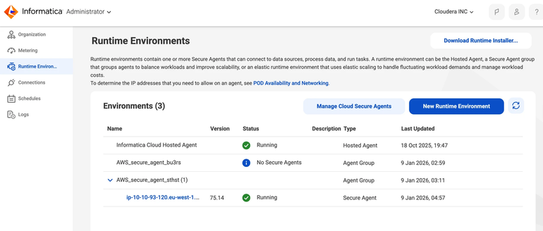

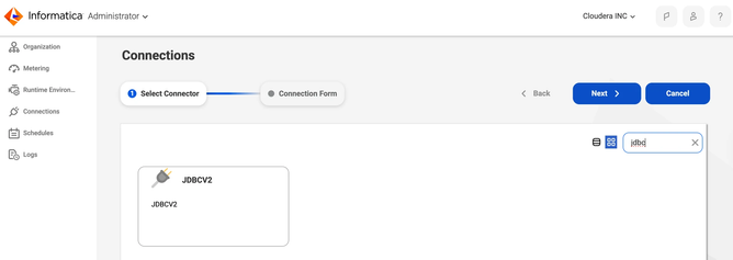

 Populate all the required data to configure the JDBCv2 Informatica connector
The runtime should be the Informatica Secure Agent we have installed previously (in AWS for this tutorial. Check pre-requisite section)
For CDW Impala via JDBC, the correct JDBC Driver Class Name is:
com.cloudera.impala.jdbc.Driver
JDBC Connection String with JWT authentication example:
jdbc:impala://coordinator-imdc-cdp-impalawaas.dw-imdccloudera-cdp-env.a465-9q4k.cloudera.site:443/default;ssl=1;transportMode=http;httpPath=cliservice;AuthMech=14;JWTString=eyJqa3UiOiJodHRwczovL2ltZGNjbG91ZGVyYS1hdy1kbC1nYXRld2F5LmltZGNjbG91LmE0NjUtOXE0ay5jbG91ZGVyYS5zaXRlL2ltZGNjbG91ZGVyYS1hdy1kbC9ob21lcGFnZS9rbm94dG9rZW4vYXBpL3YyL2p3a3MuanNvbiIsImtpZCI6IjEyWHRObklCT1pyRlRYNlcyNTlmekp5WVpDYUZOTm1QQk83bjFBTWhKVzQiLCJ0eXAiOiJKV1QiLCJhbGciOiJSUzI1NiJ9.eyJzdWIiOiJhY2FzdGVsbG8iLCJhdWQiOiJjZHAtcHJveHktdG9rZW4iLCJqa3UiOiJodHRwczovL2ltZGNjbG91ZGVyYS1hdy1kbC1nYXRld2F5LmltZGNjbG91LmE0NjUtOXE0ay5jbG91ZGVyYS5zaXRlL2ltZGNjbG91ZGVyYS1hdy1kbC9ob21lcGFnZS9rbm94dG9rZW4vYXBpL3YyL2p3a3MuanNvbiIsImtpZCI6IjEyWHRObklCT1pyRlRYNlcyNTlmekp5WVpDYUZOTm1QQk83bjFBTWhKVzQiLCJpc3MiOiJLTk9YU1NPIiwiZXhwIjoxNzY4MTU0MjYyLCJtYW5hZ2VkLnRva2VuIjoidHJ1ZSIsImtub3guaWQiOiJlZmY1MzFmNi03MjExLTRmNGQtODY2ZS04NTJmYTU3NDgzMDQifQ.o8drQwfNGo5XlbyGSV8Oj2v7RMchUpJmr6Zx4nrlQM5LX9O6FhHeclIB5xzMbEf3Y0aU-CSt-ych6y_hjJOKM5vEIghEyMEWA8dN8FlEIx9-j-v6rF2FnfuMoLIwMvTxMw9Z2duzMeRTkdPWTSmTpS_XVhXOLx7nlqPVWbV3a1IpSexuuoMFMxFI3FYRBnmHn5PHIiCB4_jwiymRNFFJqRit76kILIELMWSRKARH5gCSB5dgEnR3vpVa5GNpvo-d5lqeAoapU0PyLtIRJWWNodASv8ltN0Gnncj2PCIEhboZxzvNMBiZFSi5hf7H5_gcv6k7oaCbFZ19WCcIkYmx0A
Full details of JDBC Impala configurations can be found here
Note: Authentication
  • Authentication mechanism: JWT (AuthMech=14)
  • Username/password fields can be left empty
  • JWT token must be valid and unexpired
Note 2: For Informatica JDBC v2, the driver must be installed in the JDBC_V2-specific Secure Agent directories; generic classpath or Tomcat-based placement is insufficient. Come back to 0) Pre-reqs section
Test the connector. It should succeed
