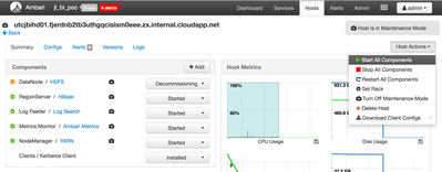

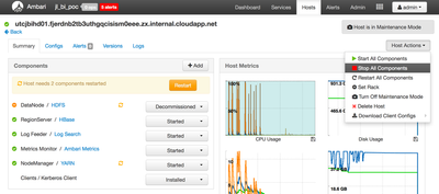

  • It takes hours to finish, depends on your existing data size9955-picture2.png

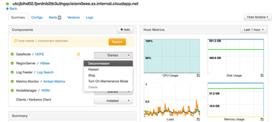

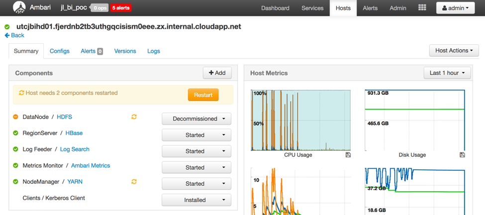

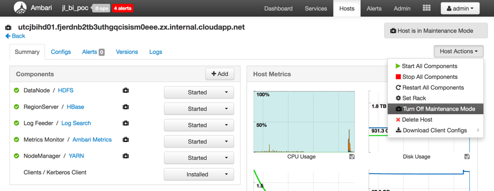

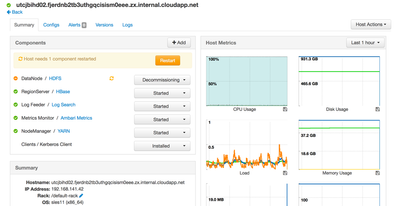

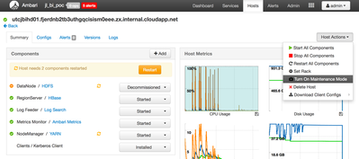

  • After change Linux disk mount configuration, start all components on the host9960-picture6.png

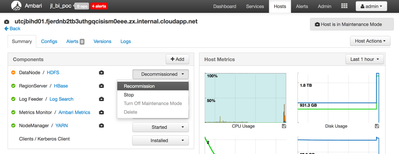

Can you please tell why do we need to stop all services on the host while only DataNode and NodeManager is affected? Why do we also need to stop RegionServer and other services?
Expert Contributor
After stopping DataNode, Hbase RegionServer still holds FDs from mounts and it needs to be stopped before you can unmount the volumes.
