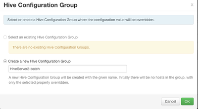

Click on the override button and enter a name for ambari hive configuration group.
One host can only be part of one ambari config group so choose the name wisely.
If you already have existing config group you would like to use, you may use that.
I choose to use new hive configuration group with name HiveServer2-batch

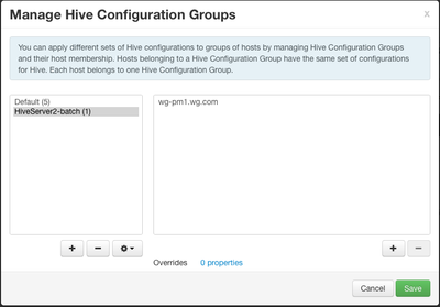

Click “Manage Hosts” to Update the hosts that are part of the new config group.
Then chose the hiveserver-batch and add the host and save

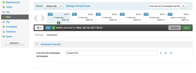

Now ambari should prompt to customize the hive.server2.zookeeper.namespace option
I chose to use hiveserver2-batch as the zookeeper namespace for hiveserver2 and click save.
