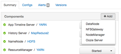

7. Add the additional Oozie server instances
Log into Ambari as a user allowed to add new Oozie server instances. This is typically a user with Ambari Administrator, Cluster Administrator, or Cluster Operator privileges. Then browse to the view for each host where the new Oozie server instance is to be installed and select "Oozie Sever" from the component "Add" dropdown menu.
New Oozie server instances may not be automatically started. This is ok since the Oozie service will need to be stopped and started later.
