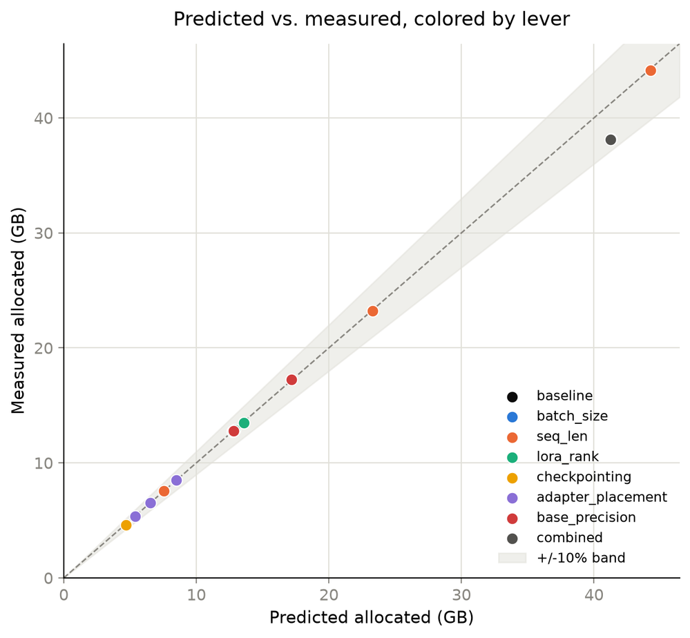

Every formula in this article was validated against a 23-configuration LoRA fine-tune sweep of TinyLlama-1.1B on an H100 80GB — varying batch size, sequence length, LoRA rank, adapter placement, base storage precision, and checkpointing one lever at a time for the core sweeps, plus four deliberately stacked combinations at the extremes. For every configuration that completed, predicted memory landed within ~8.3% of measured; every configuration that ran out of memory was predicted to run out. The two configurations that OOM'd — batch 32 with sequence 2,048, at rank 8 across all layers, with and without 8-bit Adam — needed checkpointing to fit, and checkpointing rescued both.
Predicted vs. measured peak allocated memory for the 23-configuration LoRA fine-tune sweep on TinyLlama-1.1B, colored by lever. Points sit on or inside the shaded ±10% band around the y=x diagonal; the one point below the line at ~41 GB predicted / ~38 GB measured is the stacked-lever combined configuration where the formula is 8.3% high.
Every configuration in the sweep, formula against reality: 23 points, one 8.3% miss, no fudge multipliers. Colors mark which lever was moved from the baseline.

That last row is the pattern this article was written to make visible. The stacked-lever configuration — every dial pushed hard — does not fit on the 80 GB card without checkpointing. Turn checkpointing on and it fits with 40 GB of headroom. Same model, same card, one config flag.
The worst prediction miss was on the two stacked-lever checkpointed configurations, where the formula predicts +8.3% over what was measured. The formula estimates the checkpointed peak by assuming all saved layer boundaries and one segment's transient tensors are alive at the same time; the allocator in practice releases some of the intermediate transients slightly earlier under memory pressure. That's an honest formula-side gap, not a fudge factor's worth of slack. It is reported rather than tuned away, matching the training article's disclosure of its own 11.6% miss from that sweep.
