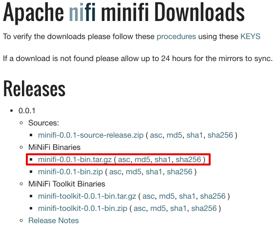

  1. Open a browser. Download the MiNiFi Binaries from Apache MiNiFi Downloads Page. There are two options: tar.gz a format tailored to Linux and a zip file more compatible with Windows. If you are using a Mac either option is just fine.
    <Display Name>
    Figure 1. MiNiFi download page
    For this tutorial I have downloaded the tar.gz on a Mac as shown above in
  2. To install MiNiFi, extract the files from the compressed file to a location in which you want to run the application. I have chosen to install it to /Users/apsaltis/minifi-to-nifi
    The image below show MiNiFi downloaded and installed in this directory:

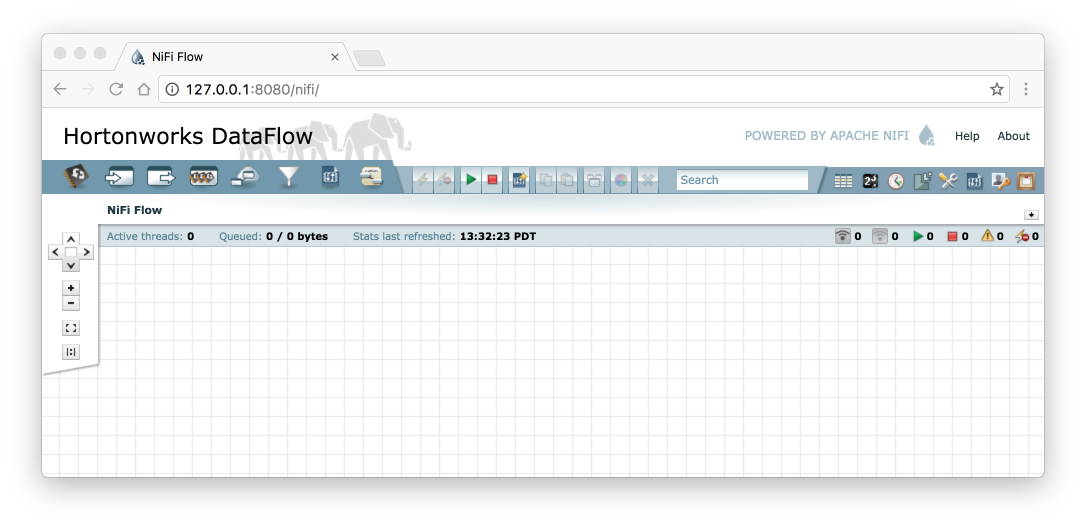

  1. Open a browser and go to: http://\:\/nifi on my machine that url looks is http://127.0.0.1:8080/nifi and going to it in the browser looks like this:
    <Display Name> Figure 2. Empty NiFi Canvas

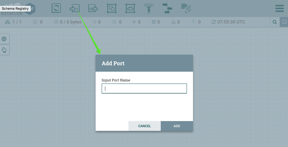

  2. The first thing we are going to do is setup an Input Port. This is the port that MiNiFi will be sending data to. To do this drag the Input Port icon to the canvas and call it "From MiNiFi" as show below in figure 3.

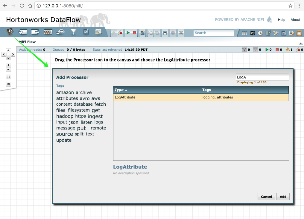

  3. Now that the Input Port is configured we need to have somewhere for the data to go once we receive it. In this case we will keep it very simple and just log the attributes. To do this drag the Processor icon to the canvas and choose the LogAttribute processor as shown below in figure 4.
    <Display Name> Figure 4. Adding the LogAttribute processor

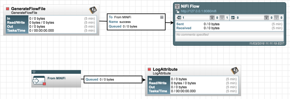

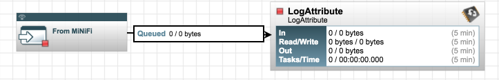

  4. Now that we have the input port and the processor to handle our data, we need to connect them. After creating the connection your data flow should look like figure 5 below.
    <Display Name> Figure 5. NiFi Flow

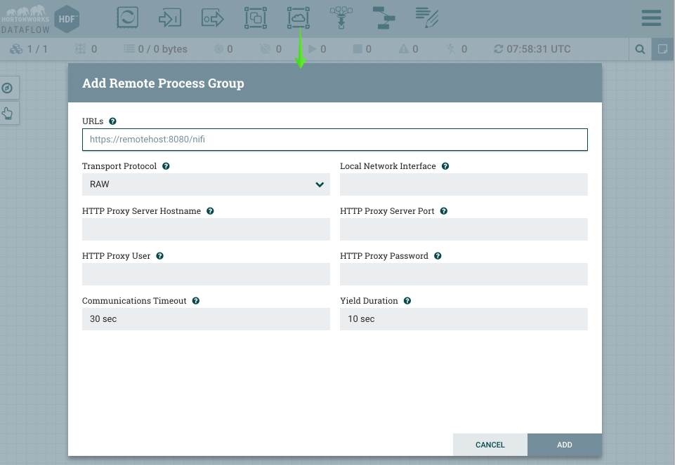

    • Add a Remote Processor Group to the canvas as shown below in Figure 6
    <Display Name>
    Figure 6. Adding the Remote Processor Group
    • For the URL copy and paste the URL for the NiFi UI from your browser

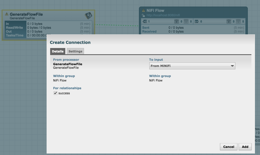

    • Connect the GenerateFlowFile to the Remote Process Group as shown below in figure 7. (You may have to refresh the Remote Processor Group, before the input port will be available)
    <Display Name>
    Figure 7. Adding GenerateFlowFile Connection to Remote Processor Group

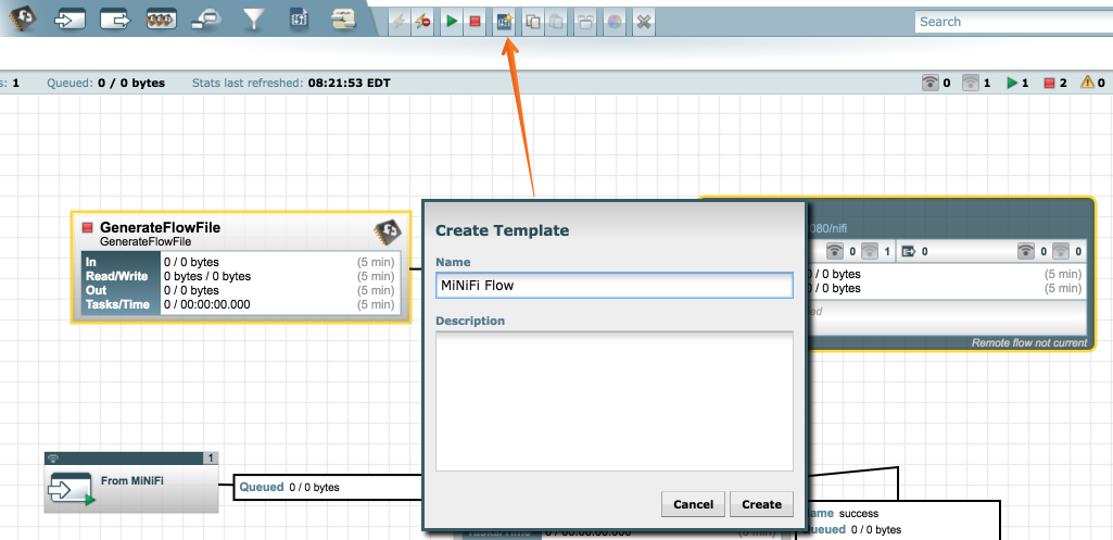

    • Create a template for MiNiFi illustrated below in figure 9. <Display Name> Figure 9. Creating a template
    • Select the GenerateFlowFile and the NiFi Flow Remote Processor Group (these are the only things needed for MiMiFi)
    • Select the "Create Template" button from the toolbar
    • Choose a name for your template

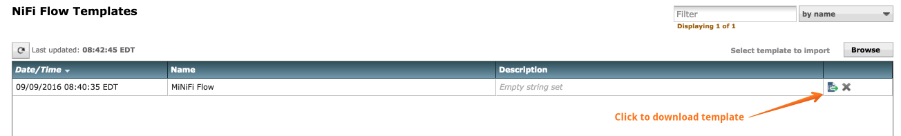

  10. Now we need to download the template as shown below in figure 11 <Display Name>
    Figure 11. Saving a template
