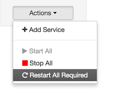

h) Once installed, Ambari will show that Storm, Kafka, Nifi need to be restarted.
Use the “Restart All Required” button (new in Ambari 2.4) to do this:
