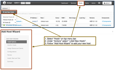

STEP 1: Add new host through Ambari. You can skip this step if the host you want to install the additional NiFi node on is already managed by your Ambari.

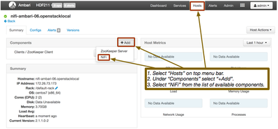

STEP 2: Under "Hosts" in Ambari click on the host form the list where you want to install the new NiFi node.
The NiFi component will be in a "stopped" state after it is installed on this new host.
*** DO NOT START NIFI YET ON NEW HOST OR IT WILL FAIL TO JOIN CLUSTER. ***

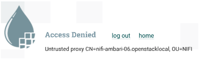

STEP 6: While you cluster is now up and running with the additional node, but you will notice you cannot open the UI of that new node without getting an untrusted proxy error screen.
You will however still be able to access your other two node's UIs. So we need to authorize this new node in your cluster.

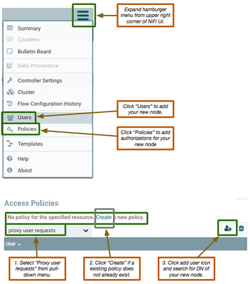

A. If NiFi handles your authorizations, follow this procedure:
1. Log in to the UI of one of the original cluster nodes.
The "proxy user requests" access policies is needed to allow users to access the UI of your nodes.
NOTE: There may be additional component level access policies (such as "view the data" and "modify the data") you may also want to authorize this new node for.

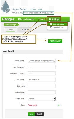

B. If Ranger handles your NiFI authorizations, follow this procedure:
1. Access the Ranger UI:
2. Click Save to create this new user for your new node. Username MUST match exactly with the DN displayed in the untrusted proxy error screen.

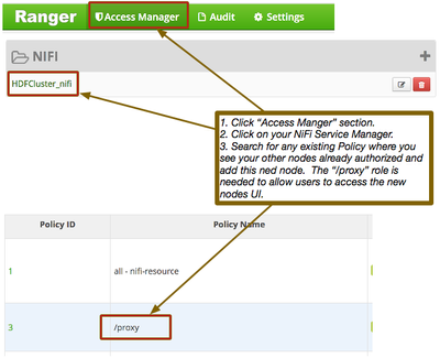

3. Access the NiFi service Manager in Ranger and authorize your new node to your existing access policies as needed:
