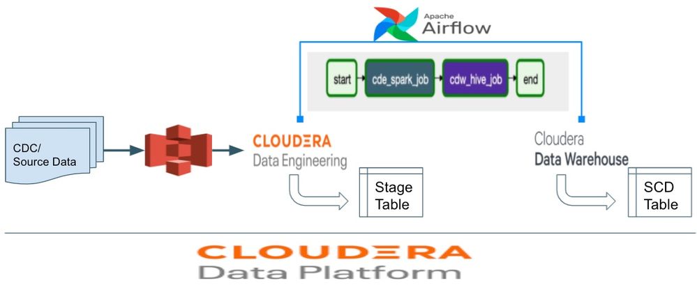

Workflow Details
Airflow will orchestrate the workflow. First, a CDE Spark job will pick up the product changes from s3. Spark will perform the required ETL and then write the output to a staging table (Hive External). Lastly, using the new Airflow CDW operator; a Hive ACID merge will be executed between the staging table and product dimension. Not rocket science. I know.

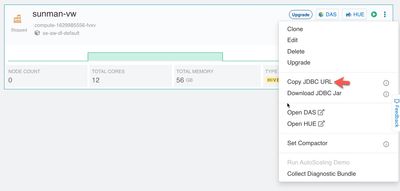

Grab the JDBC URL from the virtual warehouse
Note: SSO must be disabled
For example:
jdbc:hive2://zzz.cloudera.site/default;transportMode=http;httpPath=cliservice;socketTimeout=60;ssl=true;retries=3;

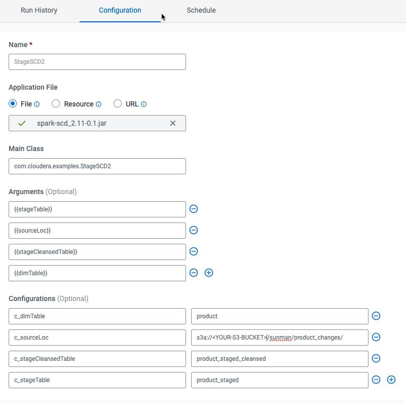

Create a CDE Spark Job
This job reads product_changes.psv file (contains the changes which need to be applied to the product dimension), performs cleansing/ETL, and stages the changes as an external Hive table.
The code is available on my Github page. If you're not interested in building the code, no worries. I have also provided the Spark jar which can be downloaded instead.
https://github.com/sunileman/spark-CDE-SCD/blob/master/target/scala-2.11/spark-scd_2.11-0.1.jar
CDE Spark Job Details
Note: For this demo to work, all job specs/args/configs must match the screen shot below
Note: Update <YOUR-S3-BUCKET> with your s3 bucket

The airflow dag flow is the following:
First, a Spark CDE job will be called to stage the product changes into an external Hive table.  Then CDW will be called to perform the Hive ACID Merge between the product dimension and staging table.  The code for the dag is here:
