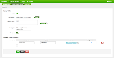

a.Sample Ranger Policy for HDFS repository in UI is as below -
Below is the rest api GET method call which we can use to get the policy as displayed above -
curl -iv -u <username>:<password> -H "Content-type:application/json" -X GET http://localhost:6080/service/public/api/repository/{id}
Eg. In above screenshot my policy id is "2"
curl -iv -u admin:admin -H "Content-type:application/json" -X GET http://localhost:6080/service/public/api/repository/2
