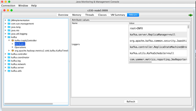

After brokers has been restarted, lets modify the logLevel with jConsole:
$ jconsole <BROKER_FQDN>:<JMX_PORT>
It launches a jconsole window, asking for Retry insecurely, go ahead with that
go to the Mbeans tab then Kafka/kafka.log4jController/Attributes, and double-click on the Value of Loggers to get all Log4j controllers
You can see the kafka logger above those presented is set to INFO.

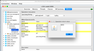

We can check it using the getLogLevel Operations entering the kafka loggerName

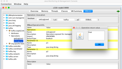

Fortunately, you can also set the value without restarting with the setLogLevel operation, putting in DEBUG or TRACE for example.
