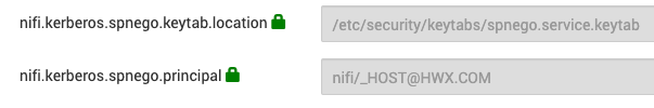

 Furthermore, SPNEGO properties through AMBARI are greyed out for:

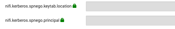

  3. Restart NiFi and/or NiFi Registry and ensure that you clear your browser cache.
  4. You should see the following on Ambari config sections of NiFi and/or NiFi registry:Screen Shot 2020-07-15 at 3.15.29 PM.png
