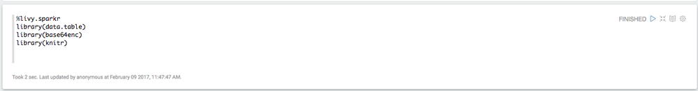

5. Confirm the packages have been installed
%livy.sparkr
library(data.table)
library(base64enc)
library(knitr)
library(ggplot2)
The above should run and finish returning nothing in output.

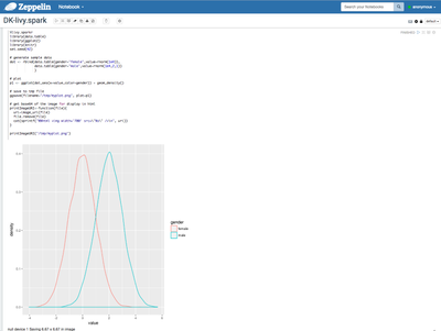

6. Run the following code to build the graphics
%livy.sparkr
library(data.table)
library(ggplot2)
library(knitr)
set.seed(42)
# generate sample data
dat <- rbind(data.table(gender="female",value=rnorm(1e4)),
data.table(gender="male",value=rnorm(1e4,2,1))
# plot
p1 <- ggplot(dat,aes(x=value,color=gender)) + geom_density()
# save to tmp file
ggsave(filename="/tmp/myplot.png", plot=p1)
# get base64 of the image for display in html
printImageURI<-function(file){
uri=image_uri(file)
file.remove(file)
cat(sprintf("%%html <img width='700' src=\"%s\" />\n", uri))
printImageURI("/tmp/myplot.png")
This will generate the following graphics

Master Guru
+1 for a nice article! I had to add "library(ggplot2)" in steps 4 and 6 which provides ggplot function.
