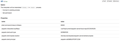

I. Default config looks like below:

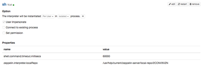

II. Do the following change:
- edit the interpreter
- change The interpreter will be instantiated from Globally to Per User and shared to isolated
- then you will be able to see and select User Impersonate check-box
- also remove
zeppelin.shell.auth.type
zeppelin.shell.keytab.location
zeppelin.shell.principal

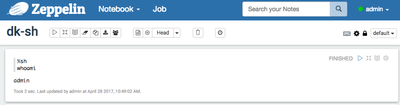

After Saving the changes and running below as admin
%sh
whoami
We get
