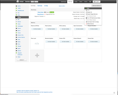

Enable HBase

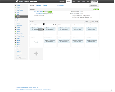

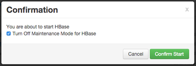

We are going to start the HBase service and turn off maintenance mode. We want to compare this sandbox with another one we will start later to show the services are different.
Click on the HBase service. The HBase summary page will be displayed. Click the Services button and select the Start menu option. You should see something simiarl to this:

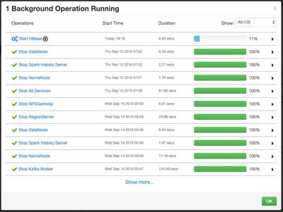

A confirmation dialog will be displayed. Check the Turn Off Maintenance Mode for HBase and then click the green Confirm Start button.
The Background Operation Running dialog will be displayed. You should see something similar to this:
You can click the green OK button.
Once HBase is running, you should see something similar to this:
You should notice that HBase is running and is no longer in maintenance mode.

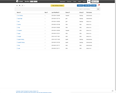

Upload file to HDFS home directory
We are going to upload a file to the user home directory on HDFS. As mentioned in the previous section, we want to compare this sandbox with another to show the directories are different.

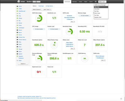

Click on the Ambari Views menu in the upper right menu. A drop down menu will be displayed. You should see something similar to this:
Click on the Files View option. You should see something similar to this:

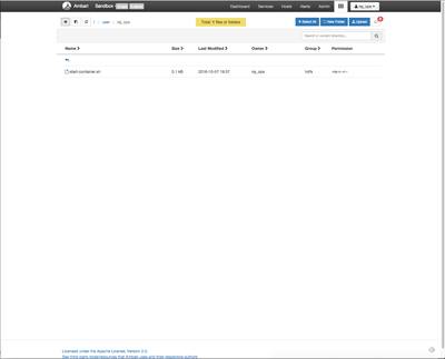

We are going to navigate to our user home directory. We are logged in as raj_ops. So click on the user folder, then the raj_ops folder. You should see something similar to this:

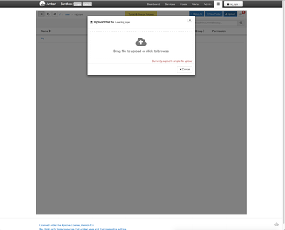

Now we are going to upload a file. Click on the blue Upload button. You should see something similar to this:
Click the cloud-arrow icon. You should see a file dialog box that looks simlar to this:
You should be in your project directory. If you are not, nagivate it that location until you see the project helper files we create. We are going to upload the start-container.sh script. Select the file and then click the open button. You should see something similar to this:

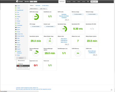

Stop the atlas-demo1 container
Now we are going to stop our container. Before stopping it, use Ambari to Stop All services. You can find that link on the Ambari Dashboard:

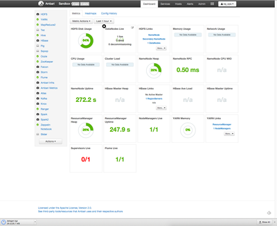

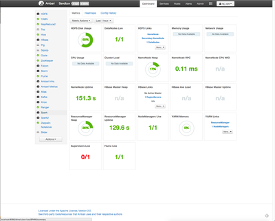

Check Ambari Services
We are going to look at the services in Ambari. In the old container we turned off maintenance mode. Login with the raj_ops username and password.
You should notice that the HBase service has maintenance mode turn on.

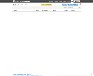

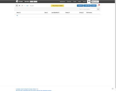

Check HDFS home directory
Now nagivate the raj_ops HDFS home directory using the Ambari Files View. Follow the process above up to get to the home directory. You should see something similar to this:
Notice the file we uploaded in the other container is not here.
