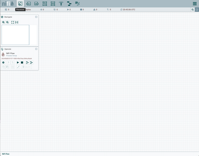

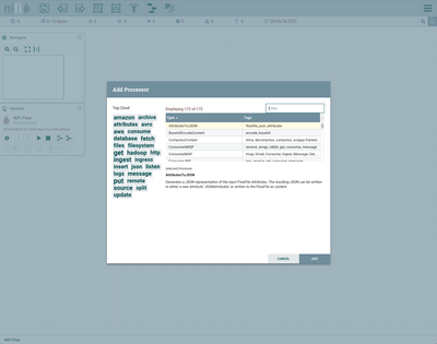

Add Processors
You add processors to NiFi by dragging the Processor icon from the left icon bar to the canvas. This screenshot shows the Processor icon:
Once you drag the icon to the canvas, you will see the Add Processor dialog box. This screenshot shows the dialog box:

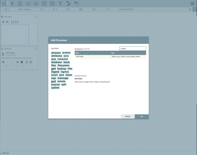

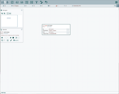

Add GetTwitter Processor
Drag the Processor icon to the canvas. In the Add Processor dialog, enter "twitter" in the Filter box. This will filter the list of processors to show you matching processor names. You should see something similar to this:
Select the GetTwitter processor and click the ADD button. This will add the processor to the canvas. Your canvas should look similar to this:

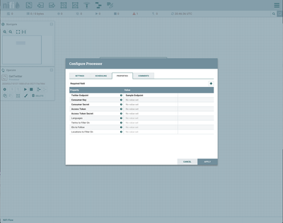

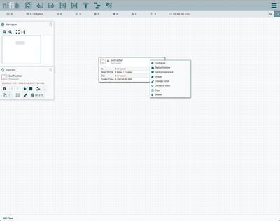

Configure GetTwitter Processor
Right click on the GetTwitter processor to display the context menu. It should look similar to this:
Click the Configure menu option. This will display the Configure Processor dialog box. It should look similar to this:
Click the Properties tab. You should set the following settings:
  • Twitter Endpoint -> Set to Filter Endpoint
  • Consumer Key -> From twitter app
  • Consumer Secret -> From twitter app
  • Access Token -> From twitter app
  • Access Token Secret -> From twitter app
  • Terms to Filter on -> Set to "nifi,hadoop,hortonworks,elasticsearch"
Once the settings are correct, click the APPLY button.

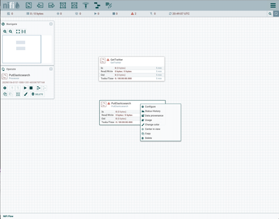

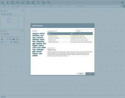

Add PutElasticsearch Processor
Drag the Processor icon to the canvas. In the Add Processor dialog, enter "elastic" in the Filter box. This will filter the list of processors to show you matching processor names. You should see something similar to this:
Select the PutElasticsearch processor and click the ADD button. This will add the processor to the canvas. Your canvas should look similar to this:

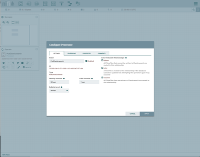

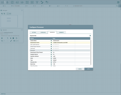

Configure PutElasticsearch Processor
Right click on the PutElasticsearch processor to display the context menu. It should look similar to this:
Under Auto Terminate Relationships, check the success box. The failure and retry boxes should not be checked and will be handled via connection later.
Now click the Properties tab. You should see something similar to this:
Set the following settings:
  • Cluster Name -> Set to elasticsearch (this should match the cluster name in the elasticsearch.yml configuration file)
  • ElasticSearch Hosts -> Set to sandbox.hortonworks.com:9300 (note the port is 9300, not 9200)
  • Identifier Attribute -> Set to uuid (this uses a unique id generated by Elasticsearch)
  • Index -> Set this to twitter (this can be any index name you want, but need to know it for Zeppelin queries)
  • Type -> Set this to default (we are not using types, so can be any type name you want)
  • All other settings left at defaults

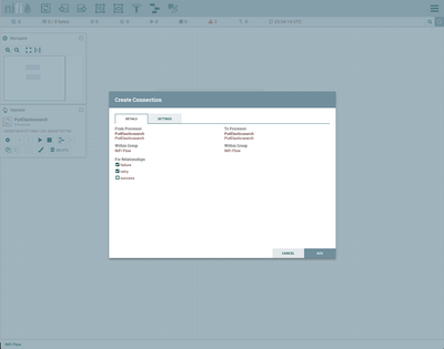

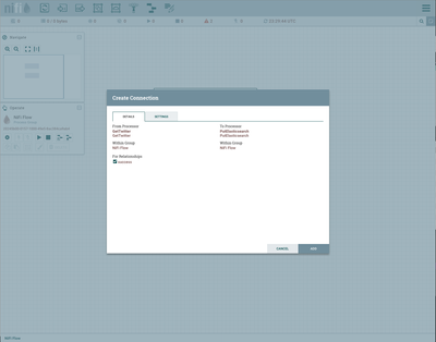

Connect Processors
Now we need to create a connector between our processors. Hover over the GetTwitter processor. You should see a dark circle with a white arrow in the middle. Drag this icon down over top of the PutElasticearch processor. The Create Connection dialog should open. It should look similar to this:
You can click the ADD button, as you don' t need to make any changes.
Now hover over the PutElasticsearch processor. Drag the arrow icon out past the PutElasticsearch processor, then back over top of it and release. This will display the Create Connection dialog. This connection is needed for fail or retry operations. Select the failure and retry options under Relationships. It should look similar to this:
Click the ADD button.

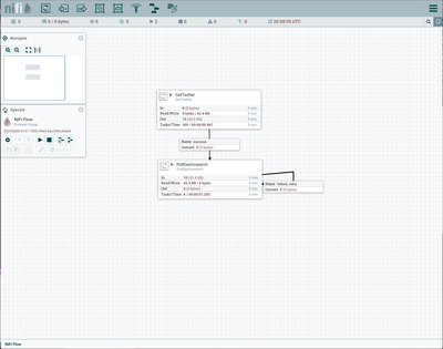

Start Processors
Right click on the GetTwitter processor to display the context menu. Click the Start option. This will start the processor. Right click on the PutElasticsearch processor to display the context menu. Click the Start option. This will start the processor.

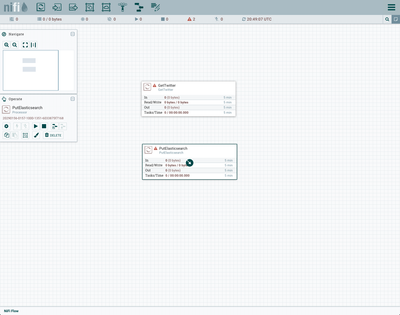

Verify Workflow
The two processors should be running. You should see something similar to this:

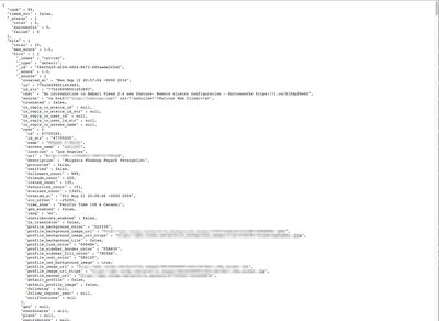

You can verify that tweets are being written to elasticsearch by typing the following in a browser window:
http://sandobx.hortonworks.com:9200/twitter/_search?pretty

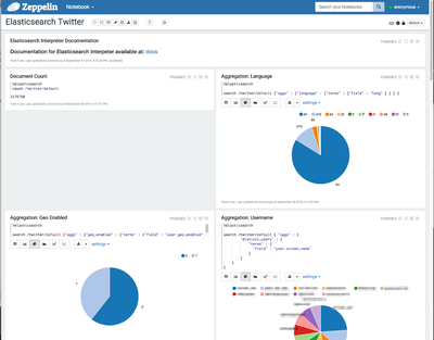

Create Zeppelin Notebook
Now you can create a Zeppelin notebook to query Elasticsearch. If you follow the Zeppelin article I linked in the Prerequisites, you should be able to use the %elasticsearch interpreter. Here is an example dashboard I created against Twitter data.
You should notice that I'm using Elasticsearch DSL to run aggregation queries agains the data. Aggregations are ideally suited for charts and graphs.

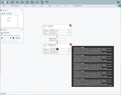

Troubleshooting
If you see a red icon in the upper right of your processors, that indicates there is a problem. If you hover over the icon, you should see relevant error message information. Here is an example screenshot where I incorrectly set my port to 9200 instead of 9300 on the PutElasticsearch processor:
