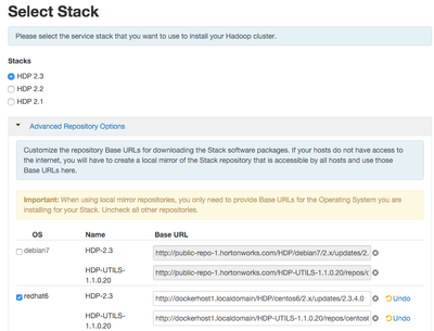

  10. Once you confirmed you can use Ambari web interface, please proceed to install HDP. If you choose to set up a HDP local repository, please replace " public-repo-1.hortonworks.com" to "dockerhost1.localdomain" (if you used default value)

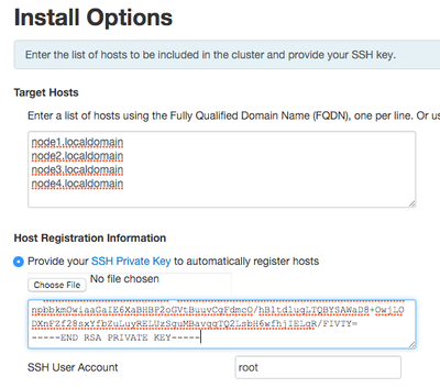

  11. Private key should be ~/.ssh/id_rsa in any node
