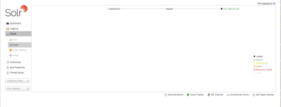

Now we can verify the collection exists in the Solr admin ui via: http://192.168.56.101:8983/solr/#/~cloud
You should see something similar to this:
As you can see, there is a single collection named collection1 which has 1 shard. You can repeat this process on solr-dc02 and see something similar.
NOTE: Remember that solr-dc01 is 192.168.56.101 and solr-dc02 is 192.168.56.202.
