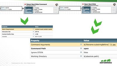

The below image shows the general setup; from top left we have a ListFile processor feeding a FetchFile processor to get the files into Nifi; we then use an UpdateAttribute processor and a SplitText processor to generate our sequenced lines of text; we then feed them into a ExecuteStreamCommand processor to run them through the 'Say' command which also acts as our blocking process to ensure serial execution; we then route the original lines out of that TextToSpeech processor into a RouteOnContent processor to recognise the command phrase 'Next Slide' which activates another ExecuteStreamCommand processor to open the appropriate slide image. Detailed configuration parameters in the linked images below, probably a bit easier to scroll through than pausing the video.

Finally we match the keyphrase 'NEXT SLIDE' here, and use a couple more expression statements to select the matching jpg file for the lines of slide text.
