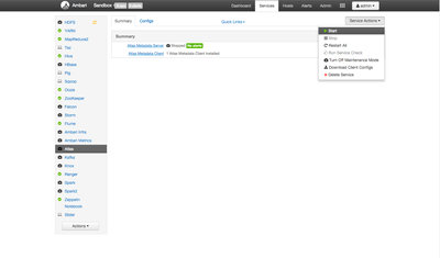

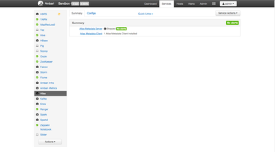

Get your sandbox up and running and log into Ambari. Click on the Atlas service link. You should see something similar to this:
Because Atlas is in maintenance mode, it will not automatically start. When you try to start it by going to Service Actions -> Start like this:

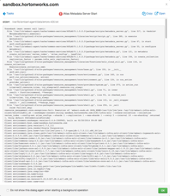

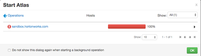

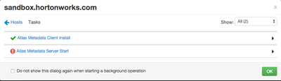

You will see the following error:
If you look at the error message provide you will see the problem is related to Solr:
Client is connected to ZooKeeper
Using default ZkACLProvider
Updating cluster state from ZooKeeper...
No live SolrServers available to handle this request
org.apache.solr.client.solrj.SolrServerException: No live SolrServers available to handle this request
 at org.apache.solr.client.solrj.impl.LBHttpSolrClient.request(LBHttpSolrClient.java:350)
 at org.apache.solr.client.solrj.impl.CloudSolrClient.sendRequest(CloudSolrClient.java:1100)
 at org.apache.solr.client.solrj.impl.CloudSolrClient.requestWithRetryOnStaleState(CloudSolrClient.java:870)
 at org.apache.solr.client.solrj.impl.CloudSolrClient.request(CloudSolrClient.java:806)
 at org.apache.solr.client.solrj.SolrRequest.process(SolrRequest.java:149)
 at org.apache.solr.client.solrj.SolrRequest.process(SolrRequest.java:166)
This is because Atlas is using the Solr instance in the Ambari Infra service, which is in maintenance mode and does not auto start. Let's start the service.

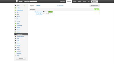

Start Ambari Infra Service
If you click on the Ambari Infra Service you should see something like this:
Click the Service Actions -> Start button. This should start Ambari Infra.

The Ambari Infra service provides a Solr instance for core HDP component access. By default this service is in maintenance mode and does not start which causes the Atlas service to fail. By starting the Amabari Infra service before Atlas, you will be able to start Atlas.
If you turn off maintanence mode for Ambari Infra, then it will auto start.
