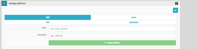

7. Create a platform definition. This is done by expand the manage platforms area of the Cloudbreak UI. We are using AWS, so create a platform by selecting AWS. The UI will look similar to this:
You can provide any Name and Description you like.

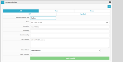

8. Create a credential. This is done by expand the manage credentials area of the Cloudbreak UI. We are using AWS, so select AWS. For ease of configuration, change the AWS Credential Type to Key Based. The Select Platform option should be set to the platform you created in the previous step. The UI will look similar to this:
You can provide any Name and Description you like. The Access Key and Secret Access Key are from your Amazon account. See this documentation to setup an access key: AWS Credentials. The SSH Public Key is found in the /home/cloudbreak/.ssh/id_rsa.pub file that was created when you followed the steps for creating the Cloudbreak instance. You can see the key by using cat on the file like this:
$ cat /home/cloudbreak/.ssh/id_rsa.pub
Note: Remember to download your credentials from Amazon. If you forget this step, there is no way to determine your Secret Access Key. You will have to delete those credentials and create new ones.

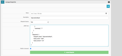

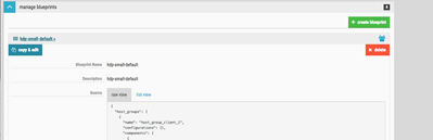

10. Now we will create our own blueprint by copying one of the existing ones. We are doing this to deploy HDP 2.5. The default blueprints will currently deploy HDP 2.4.
Note: As of Cloudbreak 1.6, the default version is HDP 2.5 so this step is not necessary.
Expand the manage blueprints section of the UI. The UI will look similar to this:
Now select the hdp-small-default blueprint. We will copy this for our HDP 2.5 blueprint. The UI will look similar to this:
Click the copy & edit button to create a copy of the blueprint. The UI will look similar to this:
You can provide any Name and Description that you like. In the JSON Text field, scroll down to the bottom. Change the "stack.version": "2.4" to "stack.version": "2.5". Click the green create blueprint button.

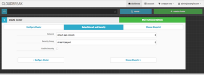

11. Now you can create your cluster. click the green Create cluster button.

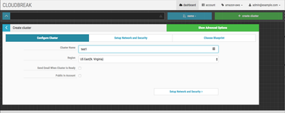

Provide a Cluster Name and select the appropriate AWS Region. Click the Setup Network and Security button.

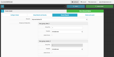

You don't need to change anything here. Click the Choose Blueprint button.

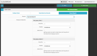

Select the Blueprint we created in the previous steps. You will notice there is an Ambari Server check box on each of the servers listed. You need to determine where you want to deploy Ambari. Select the checkbox for that server. The UI will look similar to this:

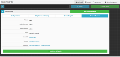

Click the Review and Launch button. This will provide a final confirmation screen with a summary of the cluster.
If everything looks good, click the green create and start cluster button.

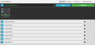

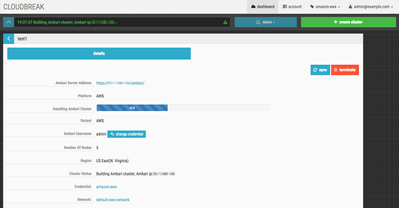

12. Cloudbreak will now start creating the cluster. The UI will look similar to this:

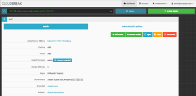

13. If you click on the test1 cluster name, you can see more information on the cluster. The UI will look similar to this:

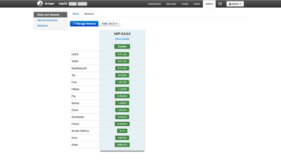

14. Once the cluster build is complete, the UI should look similar to this:

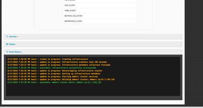

You can see more information during the cluster build process by expanding the Event History section. The UI will look similar to this:

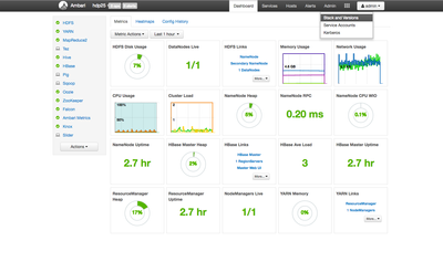

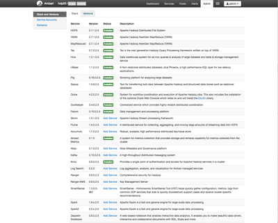

15. Once the cluster build is complete, you can log into Ambari using the Ambari Server Address link provided.
16.Once you are logged in to Ambari, select the Stacks and Versions view.
17. You can see by the components listed there are new HDP 2.5 components like Log Search and Spark2. You should see something similar to:
18 And finally, you can see HDP version by click the Versions tab. You should see something similar to:
