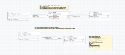

8)Now we're ready to use nifi and draw the simple flow, using SNMP processors.
Go to nifi UI and draw the following components:

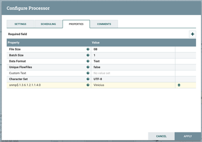

GenerateFlowFile Property

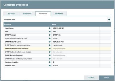

SetSNMP Property

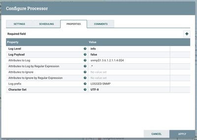

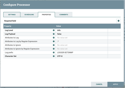

LogAttribute Property
9)Run the nifi flow (snmpset and snmpget) and check if your value is showing up in the nifi-app.log
