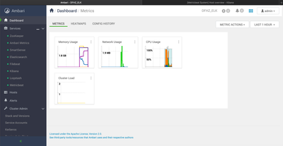

With a working install for this new Mpack in HDP 3 I can now start working on a 2 node cluster to make sure nothing else is required to get the original 4 node ELK stack installed on HDP 3. After the 2 node install cluster wizard is complete I did have to manually start some ELK services.
106803-screen-shot-2019-02-28-at-64323-pm.png106803-screen-shot-2019-02-28-at-64323-pm.png

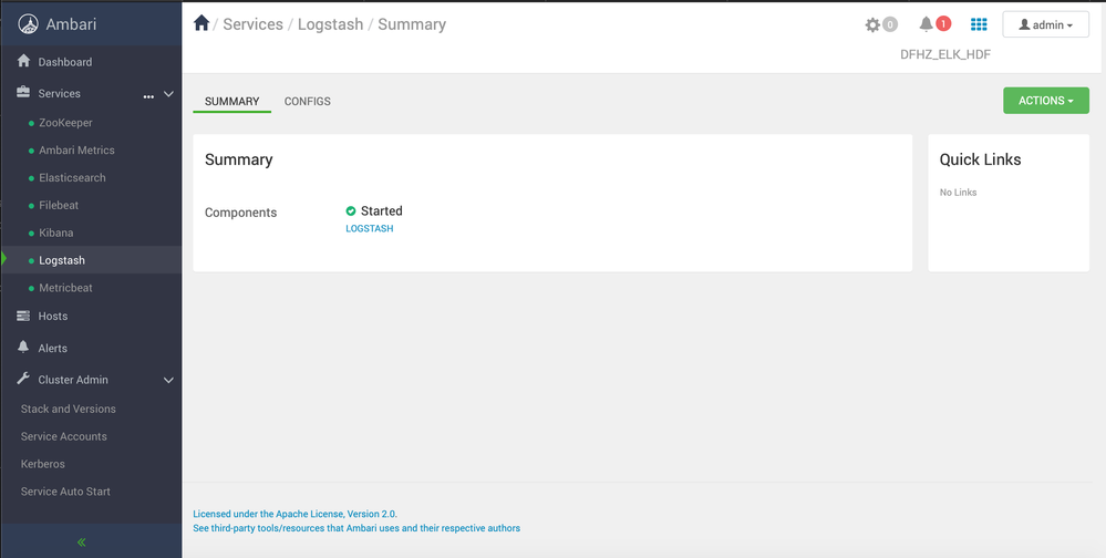

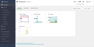

Once I identified the solution for the component python scripts I was able to get the stack installed without errors and running in HDF with only some starting issues. After starting components manually, Logstash & Kibana reporting as stopped but they are actually running.
During my next sitting I focused on the stopped services. I set the Ambari-agent log level to DEBUG and noticed some additional terminal output in the command status output from "sudo service start". After changing Kibana and Logstash to just service start, I was able to manually stop the services in the node, then start from Ambari. I am not 100% sure this sudo was related. At any rate the ELK Mpack is now installed and all services running in HDF:
106891-screen-shot-2019-03-04-at-83955-am.png106891-screen-shot-2019-03-04-at-83955-am.png
I am going to go through a few more complete tests to make sure I can get the cluster stable right after install without any additional work. I completed my final test with "sudo service" replaced with "service". During Cluster Install Wizard everything installed without errors. The only issue was a warning for Check ElasticSearch which happens faster than ElasticSearch is started up. I came back to Ambari w/ Elasticsearch, Kibana, and Logstash running. I just had to manually start FileBeats and Metricbeats.
