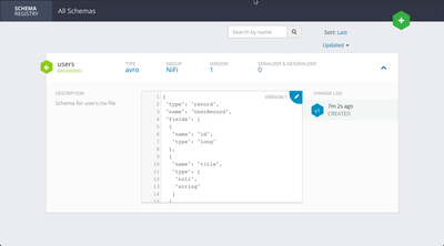

Schema Creation

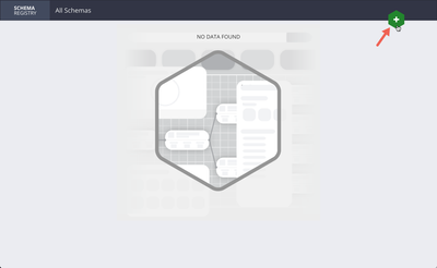

Select the "+" button to add a schema to the registry:

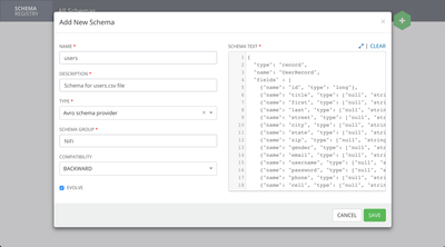

Configure the schema as follows:
The schema text is:
"type": "record",
"name": "UserRecord",
"fields" : [
 {"name": "id", "type": "long"},
 {"name": "title", "type": ["null", "string"]},
 {"name": "first", "type": ["null", "string"]},
 {"name": "last", "type": ["null", "string"]},
 {"name": "street", "type": ["null", "string"]},
 {"name": "city", "type": ["null", "string"]},
 {"name": "state", "type": ["null", "string"]},
 {"name": "zip", "type": ["null", "string"]},
 {"name": "gender", "type": ["null", "string"]},
 {"name": "email", "type": ["null", "string"]},
 {"name": "username", "type": ["null", "string"]},
 {"name": "password", "type": ["null", "string"]},
 {"name": "phone", "type": ["null", "string"]},
 {"name": "cell", "type": ["null", "string"]},
 {"name": "ssn", "type": ["null", "string"]},
 {"name": "date_of_birth", "type": ["null", "string"]},
 {"name": "reg_date", "type": ["null", "string"]},
 {"name": "large", "type": ["null", "string"]},
 {"name": "medium", "type": ["null", "string"]},
 {"name": "thumbnail", "type": ["null", "string"]},
 {"name": "version", "type": ["null", "string"]},
 {"name": "nationality", "type": ["null", "string"]}
Save the schema:

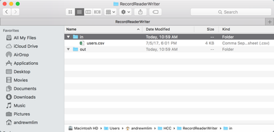

Create two local directories. One input directory and one for the JSON output. Place the "users.csv" file in the input directory.

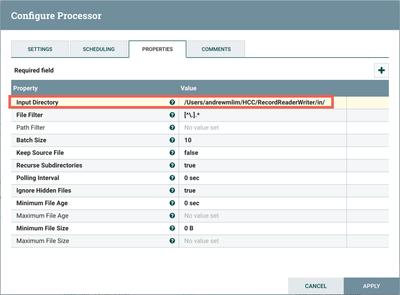

Change the Input Directory path in the GetFile processor to point to your local input directory:

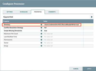

Change the Directory path in the PutFile processor to point to your local output directory:

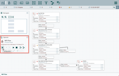

Select the root process group "NiFi Flow" by clicking an empty area of the canvas. Select the gear icon from the Operate Palette:

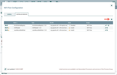

This opens the NiFi Flow Configuration window. Select the Controller Services tab and click the "+" button to create a new controller service.

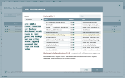

Select HortonworksSchemaRegistry from the list and click "Add":

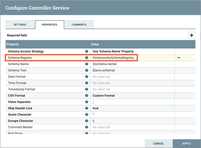

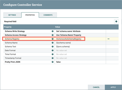

Select the Edit button ("pencil" icon) next to the CSVReader controller service. Change the "Schema Registry" property value from AvroSchemaRegistry to now point to HortonworksSchemaRegistry:
Select the Edit button ("pencil" icon) next to the JsonRecordSetWriter controller service. Change the "Schema Registry" property value from AvroSchemaRegistry to now point to HortonworksSchemaRegistry:
