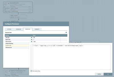

Syntax for Calling a Job
This job is stored in HDFS as /apps/logs*jar with the class name com.dataflowdeveloper.logs.Logs.

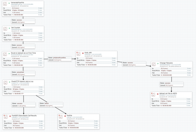

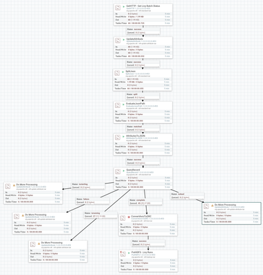

Apache Livy Status Monitoring Flow

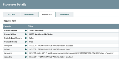

Query Record Processor for Querying and Determining with Result to Do

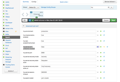

Apache Ambari Screen for Turning off CSRF Protection for Apache Livy

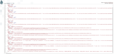

Results in JSON from Apache Livy REST Call

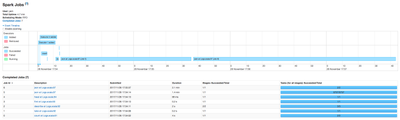

Apache Spark Job Submitted And Running

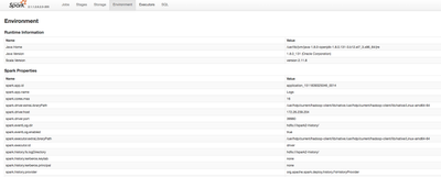

The Apache Spark Job Environment During the Run

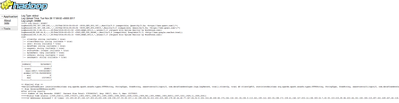

Results from the Apache Spark job Shown in YARN Logs

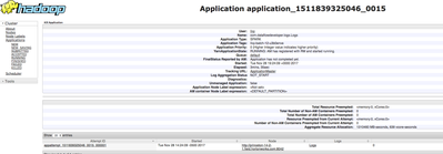

Apache YARN Run Information on the Apache Spark Job
This is the result of a completed message. As you can see we get some really cool information here. The State is really important, once it has success you can do the other processing you need.
Driver Log URL will point you to the logs, you could ingest this with Apache NiFi.
Spark UI URL will point you to the running Spark logs.
Raw REST JSON Message
  "from" : 0,
  "total" : 1,
  "sessions" : [ {
    "id" : 12,
    "state" : "running",
    "appId" : "application_1511839325046_0015",
    "appInfo" : {
      "driverLogUrl" : "http://princeton-14-2-1.field.hortonworks.com:8042/node/containerlogs/container_e02_1511839325046_0015_01_000001/livy",
      "sparkUiUrl" : "http://princeton-14-2-1.field.hortonworks.com:8088/proxy/application_1511839325046_0015/"
    "log" : [ "\t diagnostics: [Tue Nov 28 19:24:09 +0000 2017] Scheduler has assigned a container for AM, waiting for AM container to be launched", "\t ApplicationMaster host: N/A", "\t ApplicationMaster RPC port: -1", "\t queue: default", "\t start time: 1511897049505", "\t final status: UNDEFINED", "\t tracking URL: http://princeton-14-2-1.field.hortonworks.com:8088/proxy/application_1511839325046_0015/", "\t user: livy", "17/11/28 19:24:09 INFO ShutdownHookManager: Shutdown hook called", "17/11/28 19:24:09 INFO ShutdownHookManager: Deleting directory /tmp/spark-e8ada7f2-43d0-4823-8816-6e930101f2f1" ]

The Run of the chosen Apache Spark Job
Log Type: stdout
Log Upload Time: Tue Nov 28 17:59:02 +0000 2017
Log Length: 34968
===== Log Count: 206857
LogRecord(194.187.168.230,-,-,20/Feb/2016:00:00:45 -0500,GET,200,187,-,Mozilla/5.0 (compatible; Qwantify/2.2w; +https://www.qwant.com/)/*)
LogRecord(194.187.168.230,-,-,20/Feb/2016:00:00:46 -0500,GET,200,24810,-,Mozilla/5.0 (compatible; Qwantify/2.2w; +https://www.qwant.com/)/*)
LogRecord(192.0.84.33,-,-,20/Feb/2016:00:01:56 -0500,HEAD,200,0,-,jetmon/1.0 (Jetpack Site Uptime Monitor by WordPress.com))
LogRecord(66.249.64.8,-,-,20/Feb/2016:00:02:13 -0500,GET,200,28486,-,Mozilla/5.0 (compatible; Googlebot/2.1; +http://www.google.com/bot.html))
LogRecord(192.0.84.33,-,-,20/Feb/2016:00:02:15 -0500,HEAD,200,0,-,jetmon/1.0 (Jetpack Site Uptime Monitor by WordPress.com))
root
 |-- clientIp: string (nullable = true)
 |-- clientIdentity: string (nullable = true)
 |-- user: string (nullable = true)
 |-- dateTime: string (nullable = true)
 |-- request: string (nullable = true)
 |-- statusCode: integer (nullable = true)
 |-- bytesSent: long (nullable = true)
 |-- referer: string (nullable = true)
 |-- userAgent: string (nullable = true)
|summary|        bytesSent|
|  count|           206857|
|   mean|28017.72503226867|
| stddev|137716.9426060656|
|    min|                0|
|    max|         15379053|
== Physical Plan ==
*SerializeFromObject [staticinvoke(class org.apache.spark.unsafe.types.UTF8String, StringType, fromString, assertnotnull(input[0, com.dataflowdeveloper.logs.LogRecord, true]).clientIp, true) AS clientIp#10, staticinvoke(class org.apache.spark.unsafe.types.UTF8String, StringType, fromString, assertnotnull(input[0, com.dataflowdeveloper.logs.LogRecord, true]).clientIdentity, true) AS clientIdentity#11, staticinvoke(class org.apache.spark.unsafe.types.UTF8String, StringType, fromString, assertnotnull(input[0, com.dataflowdeveloper.logs.LogRecord, true]).user, true) AS user#12, staticinvoke(class org.apache.spark.unsafe.types.UTF8String, StringType, fromString, assertnotnull(input[0, com.dataflowdeveloper.logs.LogRecord, true]).dateTime, true) AS dateTime#13, staticinvoke(class org.apache.spark.unsafe.types.UTF8String, StringType, fromString, assertnotnull(input[0, com.dataflowdeveloper.logs.LogRecord, true]).request, true) AS request#14, assertnotnull(input[0, com.dataflowdeveloper.logs.LogRecord, true]).statusCode AS statusCode#15, assertnotnull(input[0, com.dataflowdeveloper.logs.LogRecord, true]).bytesSent AS bytesSent#16L, staticinvoke(class org.apache.spark.unsafe.types.UTF8String, StringType, fromString, assertnotnull(input[0, com.dataflowdeveloper.logs.LogRecord, true]).referer, true) AS referer#17, staticinvoke(class org.apache.spark.unsafe.types.UTF8String, StringType, fromString, assertnotnull(input[0, com.dataflowdeveloper.logs.LogRecord, true]).userAgent, true) AS userAgent#18]
+- Scan ExternalRDDScan[obj#9]
After writing results
===== Number of Log Records: 206857  Content Size Total: 5795662547, Avg: 28017, Min: 0, Max: 15379053
=====Status Code counts: [(404,21611),(200,170127),(302,1467),(206,87),(304,1260),(406,3242),(500,1106),(409,28),(301,4968),(403,2601),(407,123),(429,1),(405,236)]
=====IP Addresses Accessed > 10 times: [51.255.65.87,146.127.253.45,201.239.138.159,157.55.39.157,1.22.196.230,54.211.201.215,180.179.40.44,....]

Gothcha
You may need to disable this (set to false) in Ambari under Apache Spark area:
livy.server.csrf_protection.enabled
