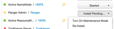

  • Head to ambari UI - to the new host page and click Re-install under Ranger admin as shown below:39960-wg01-rangeradmin-reinstall.png
