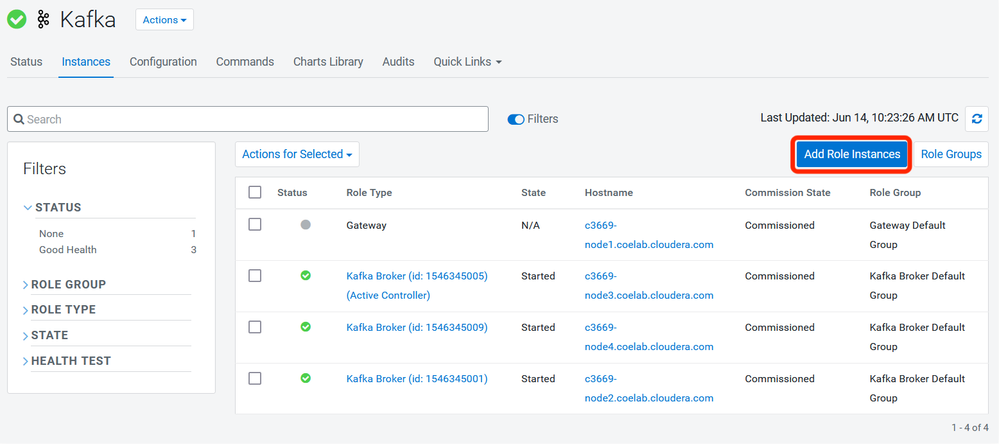

  1. Startup the new broker as a member of the old cluster:kafka_add_broker-1.pngCM UI -> Kafka -> Instances -> Add Role Instanceskafka_add_broker-2.png
    We are only adding one broker at a time. We need to replace the brokers one by one.

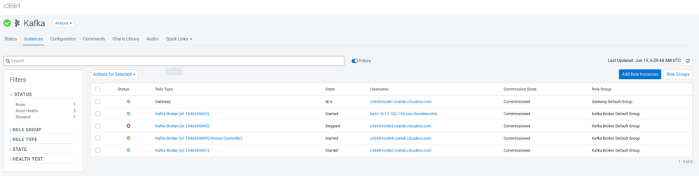

    After adding host - host-10-17-102-138.coe.cloudera.com as Kafka Broker, it should not be starting yet. Now we will see there’s stale status in Kafka Broker cluster. So, deploy the client configurations by clicking the stale status icon on CM UI.
    Now, start the newly added broker on host-10-17-102-138.coe.cloudera.com.

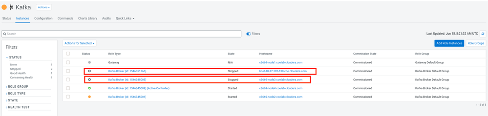

  2. Stop both the new broker and the old broker that it is replacing.kafka_stop_new_and_old_broker-1.pngIn this example, I am replacing the old broker - 1546345005 on c3669-node3.coelab.cloudera.com with the new broker - 1546351866 on host-10-17-102-138.coe.cloudera.com.

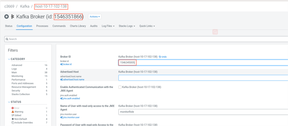

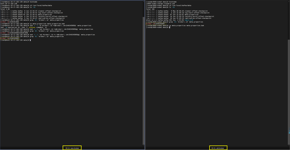

  3. Change broker.id of the new broker to the broker.id of the old one both in Cloudera Manager and in data directory/meta.properties.kafka_change_brokerId-1.pngWe need to change the broker.id to the old one on the new Broker host.kafka_change_brokerId-2.png We also need to change the broker.id to the old one on CM UI. This will trigger a staleness computation. Therefore, deploy the client configuration as indicated by CM UI.

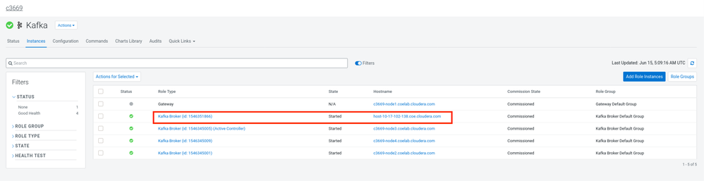

  4. Start up the new broker:kafka_start_new_broker-1.pngWe now can start the new Broker on host - host-10-17-102-138.coe.cloudera.com. Before starting, we would see WARNING message about: “lagging replicas” as of health check. After starting the new Broker, after a while (depends on the data volume on your cluster), the Kafka Broker cluster will become healthy again.
