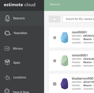

For beacons, I am using the basic Estimate three beacon collection. They have a really nice solid beacon in a silicon case, that looks nice and works well. They have a mobile app to manage, monitor and simulate as well as a cloud app.

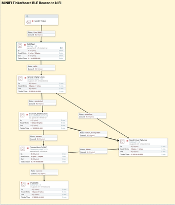

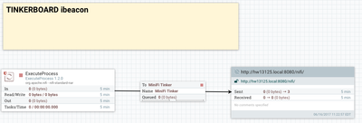

From our Apache NiFi server we have an Input Port that is receiving the messages from the Java MiniFi agent running on the ASUS Tinkerboard.

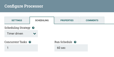

As with most of the data, I want to ingest the data every minute.

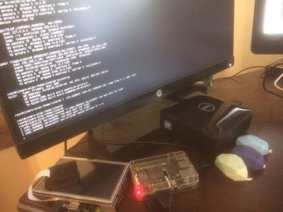

The ASUS Tinkerboard device has the read light lit up. The Estimate beacons are the colored devices to the right. For Tinkerboard's the default username is linaro.

Shell Script to ExcuteProcess
/opt/demo/py-decode-beacon/runble.sh
python bluez_scan.py

It's a very simple model, just execute the Python and send the resultant JSON to NiFi for processing and storage.
