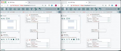

First, generate some queued flowfiles:
The queued flowfiles are distributed between both nodes in the cluster:

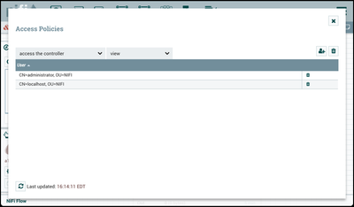

Note: If you see the error "ERROR: Error executing command 'get-nodes' : Error retrieving node status: Unable to view the controller. Contact the system administrator." You need to add "CN=localhost, OU=NIFI" to the "access the controller" view policy.

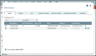

Use the command nifi disconnect-node to disconnect the node on Port 9444:
#> nifi disconnect-node -nnid 20a68479-e8dc-46c9-8612-872200e2fdab
Node ID: 20a68479-e8dc-46c9-8612-872200e2fdab
Node Address: localhost
API Port: 9444
Node Status:DISCONNECTED~

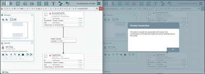

The node is disconnected:
Note: If you see the error "ERROR: Error executing command 'disconnect-node' : Error disconnecting node: Unable to modify the controller. Contact the system administrator." You need to add "CN=localhost, OU=NIFI" to both the "access the controller" modify policy.

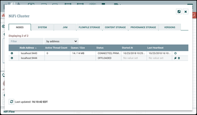

Use the command nifi offload-node to offload the flowfiles on port 9444:
#> nifi offload-node -nnid 20a68479-e8dc-46c9-8612-872200e2fdab
API Port: 9444
Node Status:OFFLOADING~
Repeating the command returns the current status of the node:
API Port: 9444
Node Status:OFFLOADED~
In the UI, it is confirmed that all the flowfiles have been offloaded to the active node:
