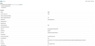

Section 1: Create a mysql interpreter for JDBC in Zeppelin
Login to Zeppelin, then go to top right corner > Admin > Interpreter and edit the jdbc interpreter.
Add the following parameters:
  • mysql.driver: com.mysql.jdbc.Driver
  • mysql.url: jdbc:mysql://localhost:3306/beast_mode_db
  • mysql.user: bmq_user
  • mysql.password: Be@stM0de
  • Add artifact: mysql:mysql-connector-java:5.1.38
Restart the interpreter and you should be good to go.
