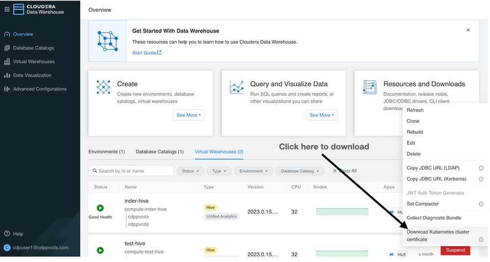

Step 1:
Download the CDW certificates for the Hive virtual cluster you want to connect to.
Assuming you downloaded the certificate chain into a file called truststore.jks (can be any name you want), create a PEM file:
% keytool -list -rfc -keystore truststore.jks | sed -ne '/-BEGIN CERTIFICATE-/,/-END CERTIFICATE-/p' > cdw-certs.pem
You should see multiple certificates in this file. Please also note that the /etc/hosts file on your ODBC client should be
able to resolve the virtual URLs exposed by CDW. keytool prompts you for a password. Here, the default password of 'changeit' was used.

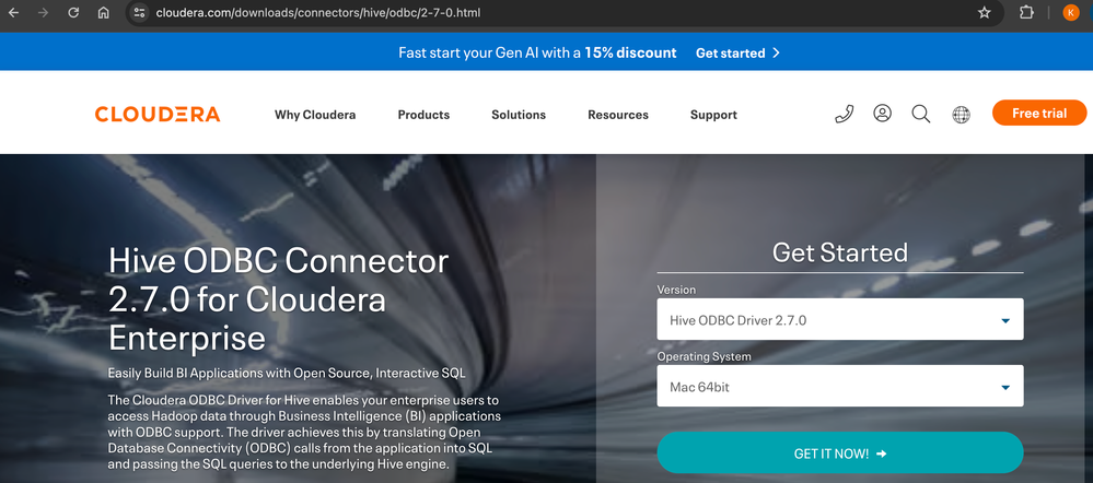

Step 3:
Download the Cloudera ODBC Driver for Hive,
e.g. try https://www.cloudera.com/downloads/connectors/hive/odbc/2-7-0.html
To ensure that the driver was installed, run: % pkgutil --info cloudera.hiveodbc
package-id: cloudera.hiveodbc version: 2.7.0
