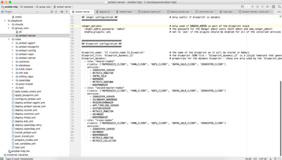

Script editor can help improve your work efficiency, here I recommend composing script in IntelliJ IDEA which can give you a neat and clear layout to put things in the place. So, we actually now have a project built in IntelliJ IDEA.
Next, I'm gonna give you a full picture of this ansible project structure. Basically, we first need to define the cluster layout, so we have an inventory file 'static' as shown in the above, and then to divide the installation into a sequence of macro steps or phases, we then defined a bunch of roles, which organize related tasks and data into one coherent structure. Roles have a directory structure here we only use some of them including default, tasks, templates, and vars.
Default and tasks directory respectively contain a main.yml which put together a sequence of micro-steps into a series of tasks. Template files can contain template variables, based on Python's Jinja2 template engine. Files in here should end in .j2, but can otherwise have any name. In our project, we use the template to generate blueprint or local repository files. The vars directory contains yml files which simply list variables we'll use in the roles.
Now, let me walk you through the installation process. The script "deploy.cluster.yml" gives out a workflow for the installation as following,

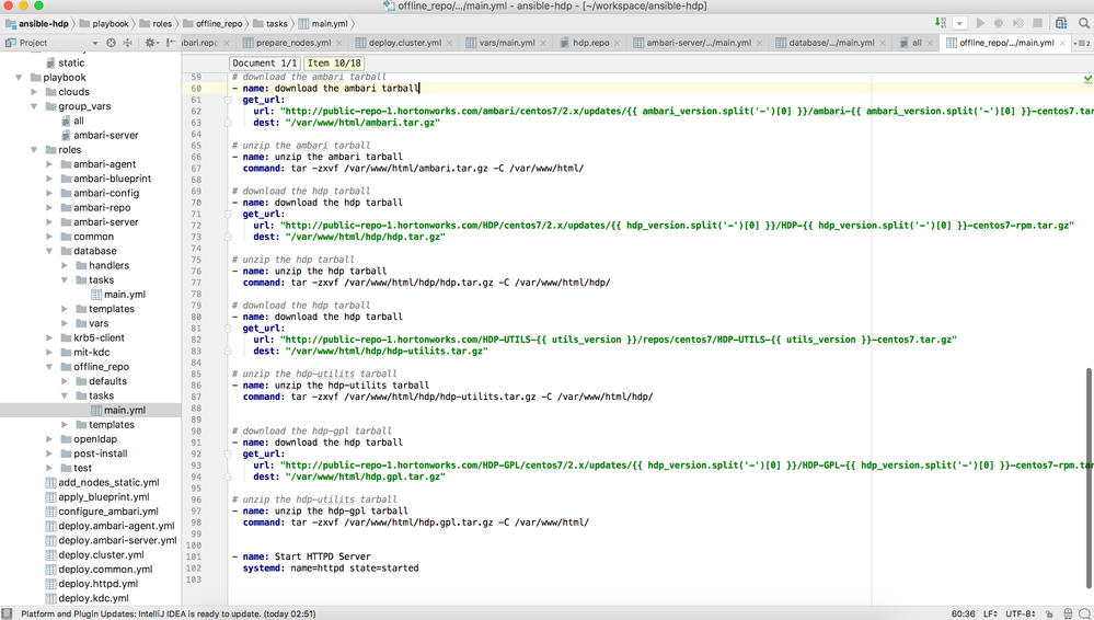

The following is the snippet from tasks of role "offline-repo", this is for downloading and decompose the tarball into http server root directory.
# download the ambari tarball- name: download the ambari tarball
get_url: url: "http://public-repo-1.hortonworks.com/ambari/centos7/2.x/updates/{{ ambari_version.split('-')[0] }}/ambari-{{ ambari_version.split('-')[0] }}-centos7.tar.gz"dest: "/var/www/html/ambari.tar.gz"# unzip the ambari tarball- name: unzip the ambari tarball
command: tar -zxvf /var/www/html/ambari.tar.gz -C /var/www/html/
# download the hdp tarball- name: download the hdp tarball
get_url: url: "http://public-repo-1.hortonworks.com/HDP/centos7/2.x/updates/{{ hdp_version.split('-')[0] }}/HDP-{{ hdp_version.split('-')[0] }}-centos7-rpm.tar.gz"dest: "/var/www/html/hdp/hdp.tar.gz"# unzip the hdp tarball- name: unzip the hdp tarball
command: tar -zxvf /var/www/html/hdp/hdp.tar.gz -C /var/www/html/hdp/
get_url: url: "http://public-repo-1.hortonworks.com/HDP-UTILS-{{ utils_version }}/repos/centos7/HDP-UTILS-{{ utils_version }}-centos7.tar.gz"dest: "/var/www/html/hdp/hdp-utilits.tar.gz"# unzip the hdp-utilits tarball- name: unzip the hdp-utilits tarball
command: tar -zxvf /var/www/html/hdp/hdp-utilits.tar.gz -C /var/www/html/hdp/
# download the hdp-gpl tarball- name: download the hdp tarball
get_url: url: "http://public-repo-1.hortonworks.com/HDP-GPL/centos7/2.x/updates/{{ hdp_version.split('-')[0] }}/HDP-GPL-{{ hdp_version.split('-')[0] }}-centos7-rpm.tar.gz"dest: "/var/www/html/hdp.gpl.tar.gz"# unzip the hdp-utilits tarball- name: unzip the hdp-gpl tarball
command: tar -zxvf /var/www/html/hdp.gpl.tar.gz -C /var/www/html/

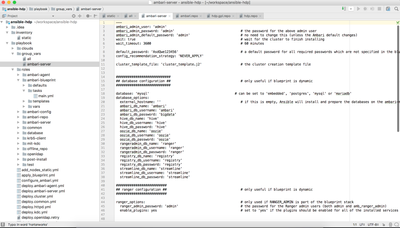

- block:
    - name: Create the ambari database (mysql)
      mysql_db:
        name: "{{ database_options.ambari_db_name }}"
        state: present
    - name: Create the ambari database user and host based access (mysql)
      mysql_user:
        name: "{{ database_options.ambari_db_username }}"
        host: "{{ hostvars[inventory_hostname]['ansible_fqdn'] }}"
        priv: "{{ database_options.ambari_db_name }}.*:ALL"
        password: "{{ database_options.ambari_db_password }}"
        state: present
    - name: Create the ambari database user and IP based access (mysql)
      mysql_user:
        host: "{{ hostvars[inventory_hostname]['ansible_'~hostvars[inventory_hostname].ansible_default_ipv4.alias]['ipv4']['address'] }}"
        state: present
    - name: Create the hive database (mysql)
      mysql_db:
        name: "{{ database_options.hive_db_name }}"
        state: present
      when: hiveserver_hosts is defined and hiveserver_hosts|length > 0
    - name: Create the hive database user and host based access (mysql)
      mysql_user:
        name: "{{ database_options.hive_db_username }}"
        host: "{{ hostvars[item]['ansible_fqdn'] }}"
        priv: "{{ database_options.hive_db_name }}.*:ALL"
        password: "{{ database_options.hive_db_password }}"
        state: present
      with_items: "{{ hiveserver_hosts }}"
    - name: Create the hive database user and IP based access (mysql)
      mysql_user:
        host: "{{ hostvars[item]['ansible_'~hostvars[item].ansible_default_ipv4.alias]['ipv4']['address'] }}"
        state: present
    - name: Create the oozie database (mysql)
      mysql_db:
        name: "{{ database_options.oozie_db_name }}"
        state: present
      when: oozie_hosts is defined and oozie_hosts|length > 0
    - name: Create the oozie database user and host based access (mysql)
      mysql_user:
        name: "{{ database_options.oozie_db_username }}"
        priv: "{{ database_options.oozie_db_name }}.*:ALL"
        password: "{{ database_options.oozie_db_password }}"
        state: present
      with_items: "{{ oozie_hosts }}"
    - name: Create the oozie database user and IP based access (mysql)
      mysql_user:
        state: present
    - name: Create the ranger admin database (mysql)
      mysql_db:
        name: "{{ database_options.rangeradmin_db_name }}"
        state: present
      when: rangeradmin_hosts is defined and rangeradmin_hosts|length > 0
    - name: Create the ranger admin database user and host based access (mysql)
      mysql_user:
        name: "{{ database_options.rangeradmin_db_username }}"
        priv: "{{ database_options.rangeradmin_db_name }}.*:ALL"
        password: "{{ database_options.rangeradmin_db_password }}"
        state: present
      with_items: "{{ rangeradmin_hosts }}"
    - name: Create the ranger admin database user and IP based access (mysql)
      mysql_user:
        state: present
    - name: Create the registry database (mysql)
      mysql_db:
        name: "{{ database_options.registry_db_name }}"
        state: present
      when: registry_hosts is defined and registry_hosts|length > 0
    - name: Create the registry database user and host based access (mysql)
      mysql_user:
        name: "{{ database_options.registry_db_username }}"
        priv: "{{ database_options.registry_db_name }}.*:ALL"
        password: "{{ database_options.registry_db_password }}"
        state: present
      with_items: "{{ registry_hosts }}"
    - name: Create the registry database user and IP based access (mysql)
      mysql_user:
        state: present
    - name: Create the streamline database (mysql)
      mysql_db:
        name: "{{ database_options.streamline_db_name }}"
        state: present
      when: streamline_hosts is defined and streamline_hosts|length > 0
    - name: Create the streamline database user and host based access (mysql)
      mysql_user:
        name: "{{ database_options.streamline_db_username }}"
        priv: "{{ database_options.streamline_db_name }}.*:ALL"
        password: "{{ database_options.streamline_db_password }}"
        state: present
      with_items: "{{ streamline_hosts }}"
    - name: Create the streamline database user and IP based access (mysql)
      mysql_user:
        state: present
  when: database == "mysql" or database == "mariadb"<br>

  "host_groups" : [
      "name" : "master-nodes",
      "configurations" : [ ],
      "components" : [
        { "name" : "MAPREDUCE2_CLIENT" },
        { "name" : "YARN_CLIENT" },
        { "name" : "HDFS_CLIENT" },
        { "name" : "INFRA_SOLR_CLIENT" },
        { "name" : "ZOOKEEPER_CLIENT" },
        { "name" : "ZOOKEEPER_SERVER" },
        { "name" : "METRICS_MONITOR" },
        { "name" : "INFRA_SOLR" },
        { "name" : "NAMENODE" },
        { "name" : "METRICS_GRAFANA" },
        { "name" : "NODEMANAGER" }
      "name" : "second-master-nodes",
      "components" : [
        { "name" : "SECONDARY_NAMENODE" },
        { "name" : "RESOURCEMANAGER" },
        { "name" : "APP_TIMELINE_SERVER" },
        { "name" : "HISTORYSERVER" },
        { "name" : "DATANODE" },
      "name" : "slave-nodes",
      "components" : [
        { "name" : "NODEMANAGER" },
        { "name" : "METRICS_COLLECTOR" }
  "Blueprints" : {
    "stack_name" : "HDP",
    "stack_version" : "2.6"

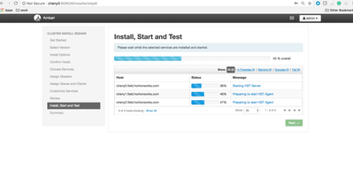

As known, the blueprint can trigger Ambari server to do the automatic installation of hdp without manual operations. The underlying procedure implemented in ansible script is same as the standard blueprint installation as in the following link
https://community.hortonworks.com/content/kbentry/47171/automate-hdp-installation-using-ambari-bluep...
And now when you turn to web browser and open the first page of ambari server, you'll see the following installation progress bar

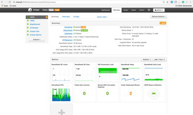

And finally, we will get an installed hdp launched on your cluster

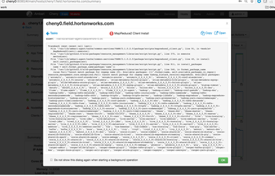

Now, need to explain why I don't employ the latest version 2.6.1.5-3 of Ambari server, because I tried it coupled with HDP 2.6.4.0-91, often reapt the failure on master node.
That error says cannot match package for hadoop_${stack_version}-mapreduce when it's trying to install mapreduce2 client. I ever tried to first manually successfully install the hpd, and then export blueprint and use this same blueprint to trigger the installation and also block at the same failure.
I've checked that this package is actually installed on the master node during ambari server installation, it should not prompt up again when installing hdp. It might be a bug, but here need more effort to dive into the concret ambari Python script, so a way around is downgrade ambari server, that is why here we use ambari server 2.5*.
