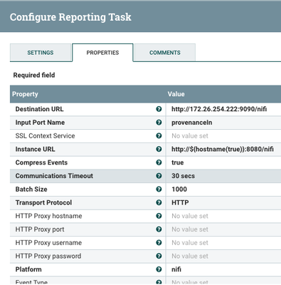

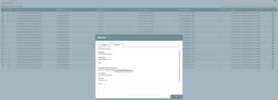

It's almost comically easy to do this. You set up a task on the server you are reporting on that sends the data to your receiver. That other server you make a simple flow to ingest and process that. I stored it to HBase as JSON as it's a good place to put a lot of data fast.
Send The Data

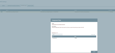

You need to create a SiteToSiteProvenanceReportingTask in Controller Settings - Reporting Tasks. It's pretty simple. Set the values above with your destination NiFi server and a port name that you have created already.

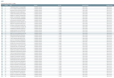

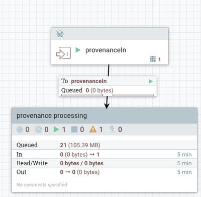

Receive the Data and Process

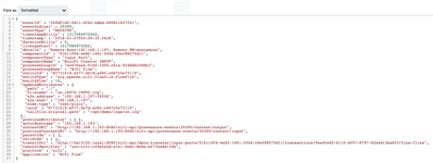

An Individual JSON Record

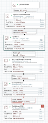

Split the JSON into Records
Save to HBase (PutHBaseJSON)
