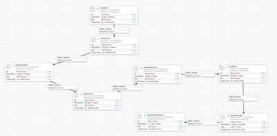

Here is the completed flow. Take note that most of this flow is just keeping track of the latest ID that we've seen, so that we can pull that back out of HDFS periodically and query Hive for records that were added beyond that latest ID.
These last two processors, SelectHive3QL and PutHive3Streaming, are the ones doing the heavy lifting. They are the ones first getting the data from the source table (based on the pre-determined latest ID) and then inserting that retrieved data into the destination Hive table.

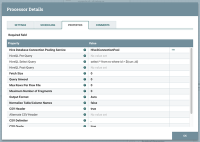

Here's the configuration for the SelectHive3QL processor. Note the ${curr_id} variable used in the HiveQL Select Query field. That ensures our query will be dynamic.

Here is the full NiFi flow:
