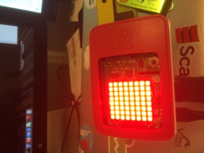

The device I am testing is a Raspberry Pi 3 Model B with a Sense Hat sensor attachment. Besides having sensors for temperature, humidity and barometric pressures it also has a 8x8 light grid for displaying text and simple graphics. We can use this to print messages (sense.show_message) or warnings that we send from NiFi. This allows for 2 way very visceral communication to remote devices. This could be used to notify local personnel of conditions.

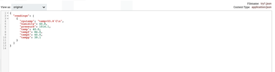

JSON File Landed in HDFS in our HDP 2.5 Cluster
[root@myserverhdp sensors]# hdfs dfs -ls /sensor
Found 2 items
-rw-r--r--   3 root hdfs        202 2016-09-09 17:26 /sensor/181528179026826
drwxr-xr-x   - hdfs hdfs          0 2016-09-09 15:43 /sensor/failure
[root@tspanndev13 sensors]# hdfs dfs -cat /sensor/181528179026826
  "readings": [
      "cputemp": "temp=55.8'C\n",
      "humidity": 40.8,
      "pressure": 1014.1,
      "temp": 40.0,
      "tempf": 84.0,
      "temph": 40.0,
      "tempp": 39.1
The final results of our flow is a JSON file on HDFS. We could easily send a copy of the data to Phoenix via PutSQL or to Hive via PutHiveQL or to Spark Streaming for additional processing via Site-To-Site or Kafka.
