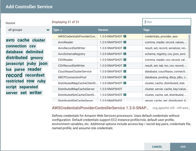

In order to start reading and writing the data, as mentioned above, we are going to need a Record Reader service. We want to parse CSV data and turn that into JSON data. So to do this, we will need a CSV Reader and a JSON Writer. So we will start by clicking the "Settings" icon on our Operate palette. This will allow us to start configuring our Controller Services. When we click the 'Add' button in the top-right corner, we see a lot of options for Controller Services:

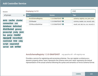

Since we know that we want to read CSV data, we can type "CSV" into our Filter box in the top-right corner of the dialog, and this will narrow down our choices pretty well:

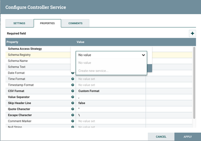

We will choose to add the CSVReader service and then configure the Controller Service. In the Properties tab, we have a lot of different properties that we can set:
Fortunately, most of these properties have default values that are good for most cases, but you can choose which delimiter character you want to use, if it's not a comma. You can choose whether or not to skip the first line, treating it as a header, etc. For my case, I will set the "Skip Header Line" property to "true" because my data contains a header line that I don't want to process as a record. The first properties are very important though. The "Schema Access Strategy" is used to instruct the reader on how to obtain the schema. By default, it is set to "Use String Fields From Header." Since we are also going to be writing the data, though, we will have to configure a schema anyway. So for this demo, we will change this strategy to "Use 'Schema Name' Property." This means that we are going to lookup the schema from a Schema Registry. As a result, we are now going to have to create our Schema Registry. If we click on the "Schema Registry" property, we can choose to "Create new service...":
We will choose to create an AvroSchemaRegistry. It is important to note here that we are reading CSV data and writing JSON data - so why are we using an Avro Schema Registry? Because this Schema Registry allows us to convey the schema using the Apache Avro Schema format, but it does not imply anything about the format of the data being read. The Avro format is used because it is already a well-known way of storing data schemas.

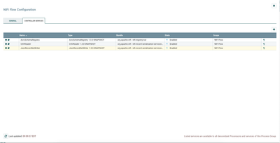

Now that we've configured everything, we can apply the settings and start our JsonRecordSetWriter as well. We've now got all of our Controller Services setup and enabled:

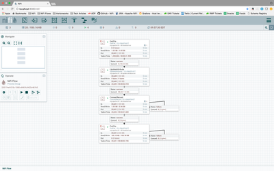

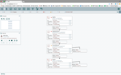

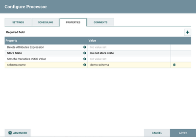

Now for the fun part of building our flow! The above will probably take about 5 minutes, but it makes laying out the flow super easy! For our demo, we will have a GetFile processor bring data into our flow. We will use UpdateAttribute to add a "schema.name" attribute of "demo-schema" because that is the name of the schema that we configured in our Schema Registry:
We will then use the ConvertRecord processor to convert the data into JSON. Finally, we want to write the data out using PutFile:

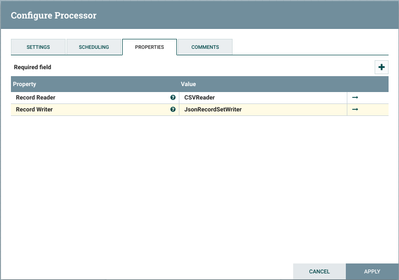

We still need to configure our ConvertRecord processor, though. To do so, all that we need to configure in the Properties tab is the Record Reader and Writer that we have already configured:
Now, starting the processors, we can see the data flowing through our system!
