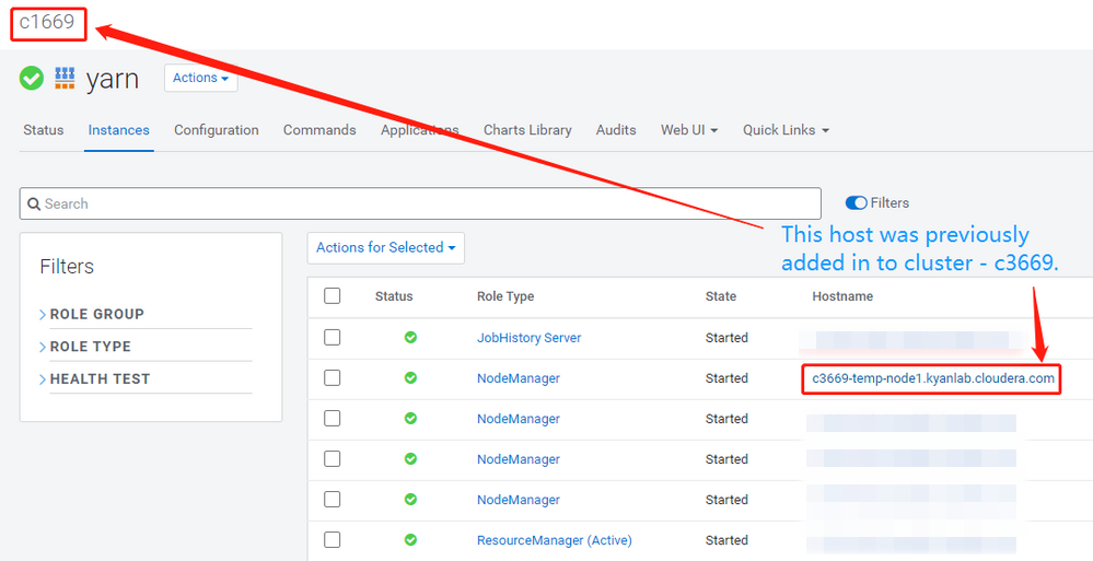

Then I created a new CDP 7.1.6 cluster, turned on Kerberos and TLS, and tried to add the host just now.
I deployed a CDP PvC Base 7.1.6 cluster with a one-click deployment script, the CM version is 7.3.1, and the new cluster is named C1669.
Therefore, the CDP version and CM version of this new cluster -- c1669 is the same as the version of the old cluster -- c3669.
After deploying the cluster -- c1669, I used the script to enable Kerberos and TLS. Now the KDC server used by the cluster is located on the host c1669-node1, which is also the host where the CM is located.
Regarding TLS I also used the same Auto-TLS case 1 as the c3669 cluster.
Now I'm adding the host c3669-temp-node1.kyanlab.cloudera.com to the newly created c1669 cluster and try to add a NodeManager role to it to see if it can be successfully started.
As a result, as I expected, the host c3669-temp-node1.kyanlab.cloudera.com was successfully added to the cluster c1669, and the newly deployed Node Manager can be successfully started.
