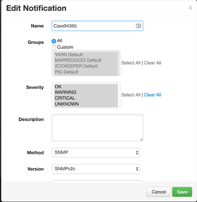

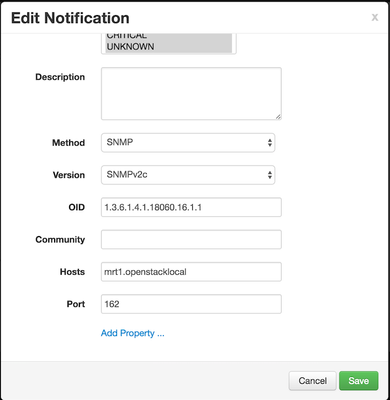

9) Below is the notification I setup on Ambari
